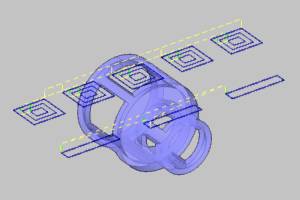

Wrapped Geometry
The Wrapped Geometry check box determines whether the geometry that you assign to features in the wrapping group is drawn unwrapped (flat) or is selected directly from wrapped (cylindrical) geometry. Note that if you change this option after creating features, you must change the geometry selection and compute the feature to update the toolpath for the existing operations to use the new setting.
Select the Wrapped Geometry check box when you want to select wrapped or cylindrical geometry.
Clear the Wrapped Geometry check box when you want to select unwrapped or flat geometry.

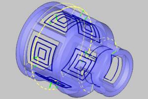

Show Toolpath as Wrapped
You can display any wrapping toolpath (whether selecting flat or wrapped geometry) as either flat or wrapped. Note that changing the state of this option automatically updates the toolpath display in the graphics area (you do not need to recompute).
Select the Show Toolpath as Wrapped check box when you want to display the calculated toolpath as wrapped (or cylindrical). This option displays the toolpath as it is cut on the machine.
Clear the Show Toolpath as Wrapped check box when you want to display the calculated toolpath flat.
Wrapping Diameter
The wrapping diameter can be set in one of two ways. You can manually enter the value, or you allow the software to use the diameter from the stock defined for the job.
  • Wrapping Diameter - type the value of the wrapping diameter used for the features under this wrapping group. The toolpath is calculated using this diameter. Generally, this value is set close to or the same as the stock diameter, but ideally this value is set to the diameter of the selected geometry.
Tip: To achieve the most accurate stepover in wrapping toolpaths, it is recommended that you set the Wrapping Diameter using the diameter at the bottom of the feature (geometry) you are cutting.
  • Use Stock Diameter - automatically sets the Wrapping Diameter value for you based on the currently defined stock geometry.
Important: If you change the Wrapping Diameter after you have already computed a toolpath, you must re-select the geometry for the feature and recompute the toolpath. Re-select in this context means to click Re/Select and just OK the selection (you don't have to actually click the geometry again unless you are changing it).

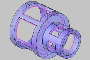

Unwrap Controls
The unwrap controls are used when you select wrapped (cylindrical) geometry. The software automatically unwraps the geometry in the background before calculating the toolpath. The unwrap controls are used by the software when unwrapping the geometry. These controls are unavailable when the Wrapped Geometry check box is cleared. When selecting geometry that is a significant distance from the wrapping diameter, the tolerance plays a more significant role in the toolpath calculation.
  • Unwrap Tolerance - defines how accurately the software unwraps the selected (wrapped) geometry before calculating the wrapped toolpath. The default setting of 0.0001 should work well for most parts, but the tolerance can be increased or decreased as needed. Using a smaller value creates more points and larger values create less points used when the software unwraps the geometry in the background.
  • Arc Fit - you can select the Arc Fit check box to allow the software to use arcs when unwrapping the geometry in the background. Clear the check box to turn off Arc Fit and the software uses only line segments in the unwrapped geometry.

Geometry Selection Tips for Wrapping Groups
When creating features under a wrapping group, you can select either wrapped or unwrapped geometry. The drawing plane for unwrapped geometry is determined by the job type.
Unwrapped Geometry for Mill Jobs
When selecting unwrapped geometry for Mill jobs, the geometry must be on the XY plane of the machining origin (machine setup) coordinate system defined for the feature.

Tip - Wrapping Output is Mirrored
If the output of a wrapped operation is mirrored (or cutting in the wrong direction) on the physical machine's rotary axes, you can resolve the issue by reversing the sign for the appropriate wrapping axis in the post processor, for example from 2 to -2.
The following image shows the result of the 4-axis wrapping tutorial after backplotting the result. The image shows that the text is cut backwards or mirrored from the expected result.
This issue is easily resolved with the following example steps.
  1. Open the post processor for the job in any text editor.
  2. Go to questions 442-444.
  3. Locate the wrapping axis that needs reversed from one of these questions.
    For this example, the rotary axis is along the X-axis, as for typical 4-axis machines.
  4. At the end of question 442, we change the sign from 1 to -1.
  5. Save the file to update the post processor.
  6. Post the program in BobCAM (with the updated post processor), and compare the result to the previous NC program.
For this example, the change we made reverses the direction of the A-axis rotation angles in the NC program.
After posting the program with the modified post processor and backplotting, the expected result is achieved.
