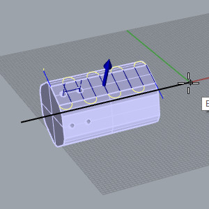

  1. In the Rotation Axis group, under Start, click Pick.
    The Toolpath Pattern dialog disappears and the Toolpath Pattern Picking dialog appears in the Data Entry Manager.
  2. Click the left end of the line.
    The point is added to the Selected Geometry list.
    The Toolpath Pattern dialog returns.
  4. In the Rotation Axis group, under End, click Pick.
  5. Click near the right end of the line.
  6. Click OK.

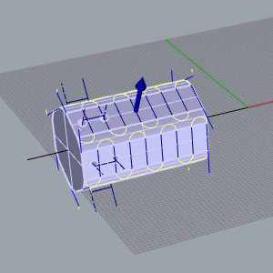

  1. To compute the toolpath pattern, click OK.
The result is shown next.

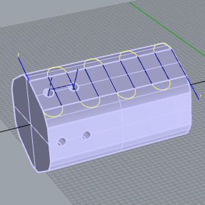

  1. To simulate the program, in the click Simulation.
After simulating, the stock model appears as shown next.

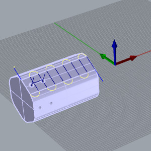

The following image shows the two original features that are used to create the toolpath pattern.

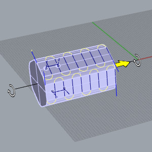

Next is an image of the features with only one copy defined. Notice that the pattern is rotated in the positive direction by using the right-hand rule of the defined rotation axis. (The yellow dot defines the start of the rotation axis and the yellow arrow points in the positive direction of the rotation-axis (line) as selected in this example. The black arrows represent the positive direction of rotation that is used by the pattern.)
