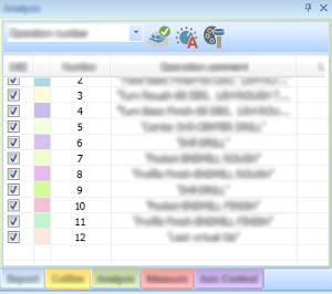

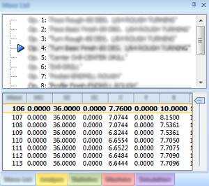

Analysis and Information Tabs
The Analysis and Information tabs that display on the right side of the simulation window are used to access the many extremely powerful simulation tools, such as the Toolpath Analysis, Stock Analysis, the Move List, and many others.

Move List

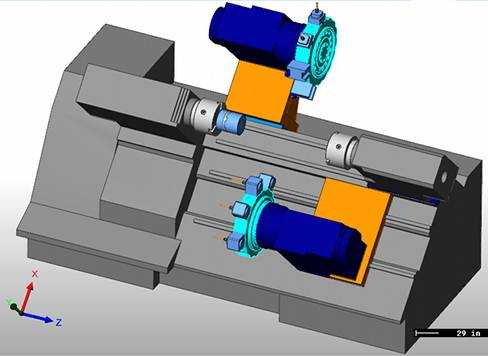

The Machine Model (Machine Simulation Pro)
For customers that have purchased the full machine simulation, you can add geometry (.stl) files to define all of the machine elements that display in the simulation window. This is extremely beneficial, for example, for multiaxis customers that need to confirm that all machine movements during the program are collision free.
To learn about defining your machine, view the Current Settings Default and How to Create a Machine.
