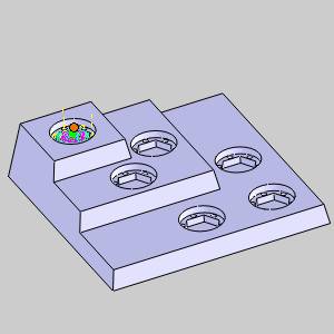

Specified Points
This options allows you to handle situations that do not fall neatly into the a simple translation pattern. Pick the Start point, then pick the positions where the copies should be created.
Toolpath to be patterned
Start Point
Positions
Result
Start
Pick the first point. This is the point the others will be measured from to determine the X, Y, and Z distances the copies need to be moved to.
  • X - is the distance from the current X Axis location of the machine setup.
  • Y - is the distance from the current Y Axis location of the machine setup.
  • Z - is the distance from the current Z Axis location of the machine setup.
  • Pick - selecting this option will hide the dialog, and launch the Toolpath Pattern Picking dialog to allow you to select geometry from the graphics area to define the end location. The nearest snap point of the selected entity is used.

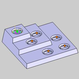

Positions
The Positions group defines the end positions of the toolpaths to be patterned. To define the Positions, you can use the Pick method, or type in coordinate values to add manually.
Pick
  • Pick Positions - selecting this option will hide the dialog, and launch the Toolpath Pattern Picking dialog to allow you to select geometry from the graphics area to define the end location. The nearest snap point of the selected entity is used.
Enter
Allows you to manually enter the end positions of the pattern copies. Enter the X, Y, and Z end values and click Add to create an additional copy.
  • Add - creates an additional position in the list below using the current values.
  X Y Z
0 2.0000 1.0000 0.0000
1 3.0000 2.2500 0.2500
2 0.0000 -2.0000 0.0000
  • (Move Up) - moves the selected Position up one level.
  • (Move Down) - moves the selected Position down one level.
  • (Delete) - removes the selected Position from the list.
Machining Order
  • Optimized - the tool movement is reduced in the NC program.
  • Pick Order - outputs the positions in the NC program in the order they were selected for the pattern.
