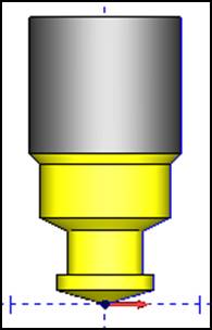

Custom Chain
Custom Tool
Custom Chain
Custom Tool

  1. When you confirm the selection, the software returns you to the Create/Modify Tool dialog box for you to finish defining the tool. A preview of the custom tool displays on the right side of the dialog box. The software automatically sets some tool parameters based on the selected profile, but you must confirm all parameters.
