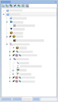

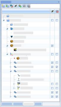

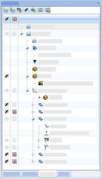

Look and Feel
- Style - allows you to adjust whether the Blank/Unblank and Post Yes/No states are accessed through the context menu only (Classic), or whether they are shown in columns in the CAM Tree and used as toggles (Extended).
Classic | Extended |
- Status Location - allows you to adjust whether the Blank/Unblank and Post Yes/No toggles are located on the left or right side of the CAM Tree.
Left | Right |
- Status Style - allows you to adjust whether the Blank/Unblank and Post Yes/No toggles are shown as icons or check boxes.
Icons | Check boxes |
