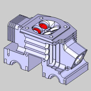

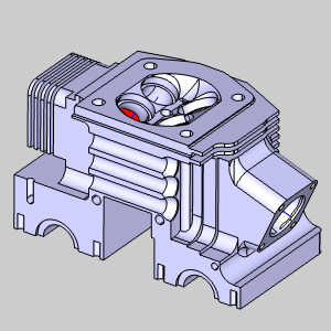

In this example, you create toolpaths that can be used to rough and finish the inside of a port.

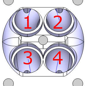

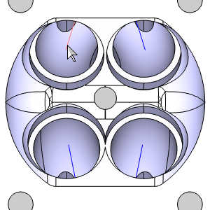

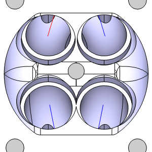

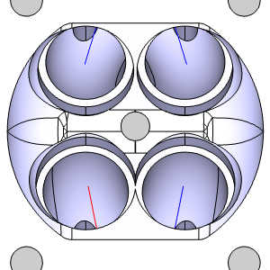

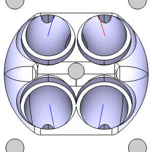

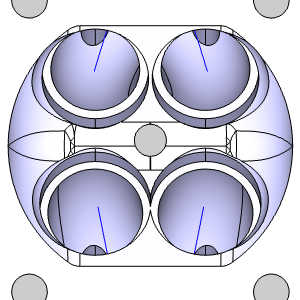

Part sections
In order to keep things clear, we will be referring to the ports by their position when viewed from a top view.
Top view:
  • 1) Top Right
  • 2) Top Left
  • 3) Bottom Left
  • 4) Bottom Right

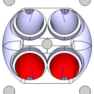

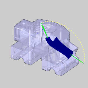

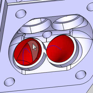

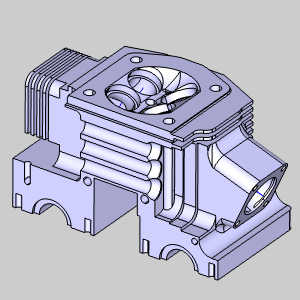

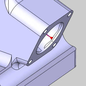

Step 5) Surface paths
  1. In the Pattern group, select Roughing from the list.

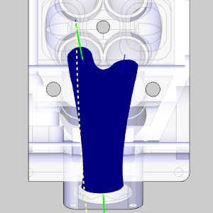

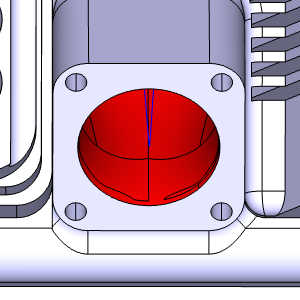

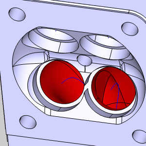

  2. In the Part definition group, click the ellipses button next to Machining surfaces.
    The Mill Multiaxis Wizard disappears, and the Re/Select Geometry dialog opens allowing you to select the required geometry.

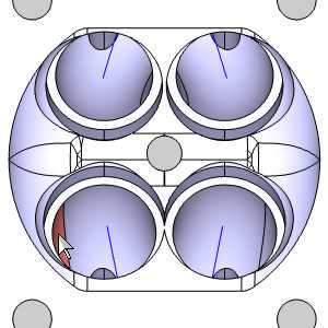

  3. Select each the surfaces which comprise the bottom port.
    For the time being ensure the surface, seen in two different angles in the images, below is left out.
    Rotate the part to select the remaining surfaces in the front.
  5. Set the Offset value to 0.02.
  6. Deselect the Automatic spine check box.

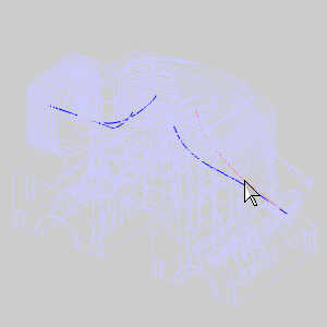

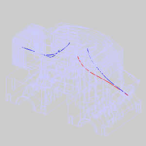

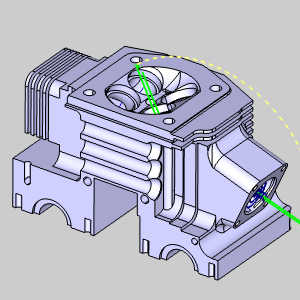

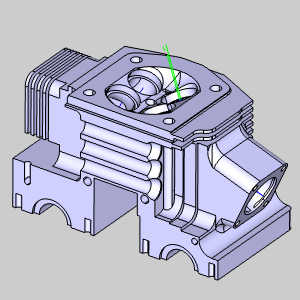

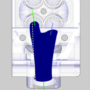

  7. Click the ellipses button that appears with the Spine.
  8. Click the spline on the left to assign it as the Spine geometry.
  9. Click OK.
  10. In the Surface quality group, set the Cut tolerance to 0.001.
  11. In the Stepover group, set the Maximum stepover and the Depth step to 0.2.

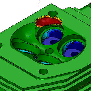

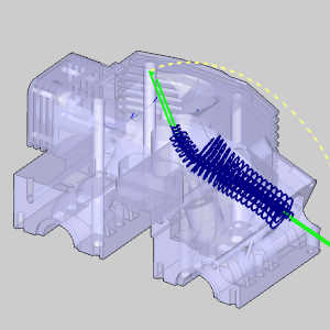

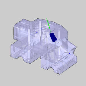

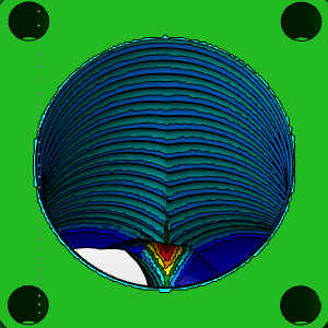

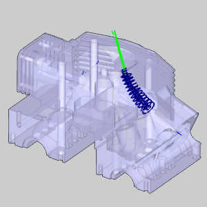

Step 8) Simulation
  2. Click Play to view the operations in simulation.
    This will allow you to ensure this operation is free of collisions and to check the deviation report to verify removal of all the material.
    Notice the port operation is beginning from the bottom of the part.
Tip: You can also use the Next Op button to skip forward by operation, you could click on a particular Op. number in the Move List tab, or just drag the progress bar to the end of the simulation.

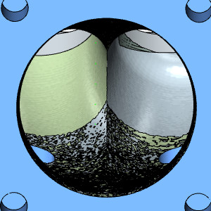

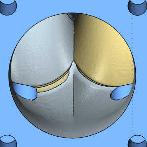

  1. Once the simulation is finished click in the Analysis tab and choose Deviation from the drop down list.
  2. Click Min/Max Detection, and then Refresh Cutsim to view the deviation report.
    Notice the gouge in the port.
  4. In the File menu, click Save.

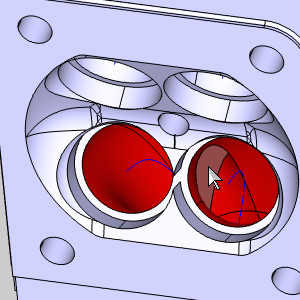

Step 9) Updating the feature geometry
  1. Expand the Geometry folder of the feature and right-click Machining Surface/Mesh.
    The Mill Multiaxis Wizard disappears, and the Re/Select Geometry dialog opens with the currently selected geometry already in the list.
  2. Select the surface we left out of the selection earlier.

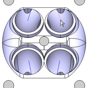

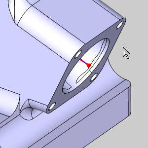

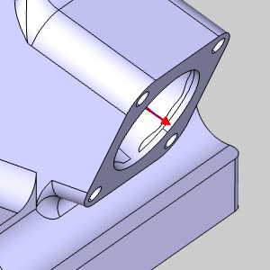

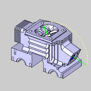

  4. In the Geometry folder of the feature, right-click Port Spine and select Modify.
    Notice the direction of the arrow on the spine we assigned for the feature.
    This arrow indicates the direction of the feature from the top to the bottom, and needs to be flipped in this case.
  5. Click in the graphics area to flip it.
  6. Click OK.
  7. Right-click the feature and select Compute All Toolpath.

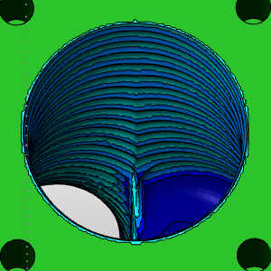

Step 10) Simulation
  2. Click Play to view the operation in simulation.
    Notice the port operation is beginning from the top of the part now that we have switched the direction of the spine.
  3. Once the simulation is finished click in the Analysis tab and choose Deviation from the drop down list.
  4. Click Min/Max Detection, and then Refresh Cutsim to view the deviation report.
    Notice the gouge inside the port has been correct. However, notice we now have a gouge on the top of our part.
  5. To close simulation, in the BobCAM menu, click Exit Simulation.
  6. In the File menu, click Save.

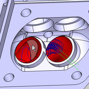

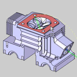

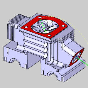

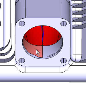

Step 11) Add check surfaces
  1. Right-click the feature and select Edit.
  2. Click Parameters to go to the Surface paths page.
  3. Click the Gouge check tab.
  4. In the last group, select the Check surfaces check box.
    An ellipses button appears.
  5. Click the ellipses button to open the Feature Geometry Picking dialog.
  6. Select the surfaces seen in the images below, as these would be the most commonly gouged.
  7. Click OK.
  8. Click Compute.
Note: At this time, you could double check the simulation to ensure your check surfaces are eliminating the gouges found.

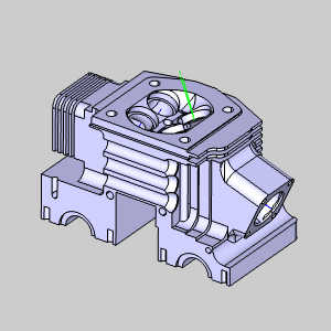

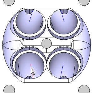

  3. In the Part definition group, click the ellipses button next to Spine.
    The Feature Geometry Picking dialog appears with the currently assigned spine in the Select Items list.
  4. Click the Delete All button to deselect the spine.
  5. Select the spine for the right port.
    The geometry is added to the Selected Items list.
  6. Click OK.

    Even without the deviation report we can see the middle is not finished.

Step 4) Updating the first finish
  1. In the CAM Tree, right-click Finish Left Both Mid and select Rename.
  2. Update the name to Finish Left Both Max Bottom and press Enter.
  3. Right-click this feature again and select Edit.
  4. Click Parameters to move to the Surface paths page.
  5. In the Area group, update the Machine to selection to Max. from bottom.
  6. Click Compute.
    In the images below you can see how this forces the toolpath further up the ports.
Step 5) Simulation

Step 2) Assigning geometry
  1. For the two features in the Rough group folder, right-click Machine Surface/Mesh, select Re/Select, and pick all port surfaces.
    These roughing features should include the additional surface between the two ports.
  2. For the two features in the Finish group folder, right-click Machine Surface/Mesh, select Re/Select, and pick all port surfaces.
    These finishing features should exclude the additional surface between the two ports.
  3. Assign Spine geometry for all features.
    Left port spine.
    Right port spine.
  4. Assign Gouge Check Surfaces for all features.
  5. Compute each of the features.
Step 3) Simulate the end result
  3. Run a deviation report to ensure the part is completed properly.
  4. To close simulation, in the BobCAM menu, click Exit Simulation.
  5. In the File menu, click Save.
