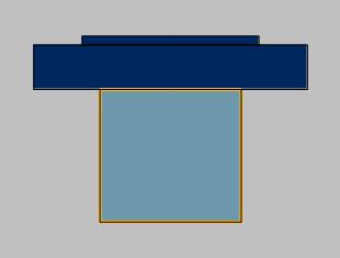

To define the first element, in the Element List, click Cylinder.
In the Element Parameters list, type the following values.

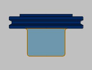

To define the next element, in the Element List group, click AddCylinder, and type the following values.
Be sure to click the arrow next to Top Chamfer, and then click Top Fillet.

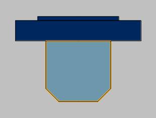

Click Add Cone, and type the following values.
Click Add Cone.

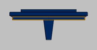

After adding this cone, you realize that a cylinder is needed before the cone.
Instead of deleting the cone, click Add Cylinder.
To reorder the elements, click Move Up.
With the cylinder selected, type the following values.
In the Element List, select the cone that was previously added, and type the following values.
Click AddCylinder, and type the following values.

Tip: The center section (V-flange) of the tool holder uses multiple cylinders and cones. To create a chamfer that is not 45 degrees, you use a cone. To create a 45 degree chamfer, you use a cylinder with the chamfer option.

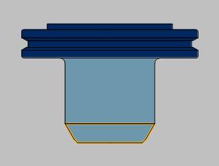

Since the first element of the arbor is a cylinder, in the Element Parameters group, type the following values.
In the Element List, click AddCone, and type the following values.
Tip: The cylinder element (step 4) has a diameter of 1.97 with a bottom fillet of 0.118. The cone element (step 5) has a diameter of 1.97 with a top fillet of 0.118. When two elements share the same diameter where they meet, you can apply a fillet across the two elements. To apply the fillet across the two elements, you must use the same fillet value for each element (Top Fillet of one element and the Bottom fillet of the next).
To finalize the new tool holder/arbor, click OK.
You have added a stubby CAT 50 tool arbor to the CAT 50 category.

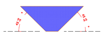

How to Measure Angle Mode
Bottom Angle Mode = 45 degrees |
