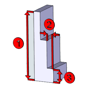

Geometry
Parameters - allows the dimensions of the chuck body the be defined with user entered values for each of the parameters:
Jaw Height (1) - sets the height of the jaw.
Step Height (2) - sets the height of steps in the jaw.
Step Depth (3) - sets the depth of steps in the jaw.
- Thickness - sets the thickness of the jaw.
