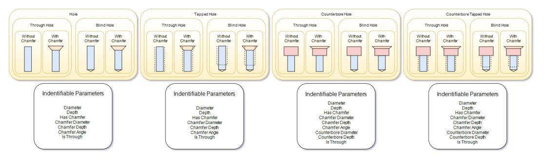

The Hole Recognition in BobCAM is able to automatically identify the 4 types of supported hole features from the selected geometry:
- Hole
- Counterbore Hole
- Tapped Hole
- Counterbore Tapped Hole
In order to create the features, certain parameters are also identified from the geometry:
