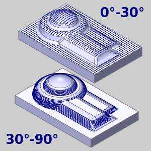

Angle Range
The Angle Range parameters allow you to define an angle interval for which the toolpath is created. You can machine inside of the range or outside of the range. This allows you to define steep and shallow areas of the part model so you can optimize the operation.
- The toolpath will not be limited by the Angle Range.
- The toolpath will be limited based on the Angle Range values.
Slope Angles
- Angle
Start - determines the starting angle for the angle range.
This value must be between 0-90 degrees and it must be less than the
Angle End.
- Angle End - determines the ending angle for the angle range. This value must be between 0-90 degrees and it must be greater than the Angle Start.
Machining Area
Machine Between Slope Angles - forces the operation to only create toolpath inside of the Slope Angles.
Machine Outside Slope Angles - forces the operation to only create toolpath outside of the Slope Angles.
