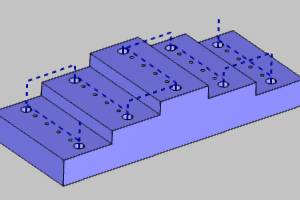

  • Standard Drill
    Standard drilling, the default drilling type, is used when the tool orientation to drill the holes is parallel to the main spindle direction, usually the Z-axis. This includes face drilling for Mill Turn jobs. Standard drilling may also be used with index systems, for example, with 3x2 machining on a 5-axis machine where you index to a plane and then perform 3-axis machining (although multiaxis drilling eliminates the need to create index systems).
    Mill or Mill Turn Standard Drilling
    The following images show toolpath examples of standard drilling for both Mill and Mill Turn jobs.
Mill Standard Drilling

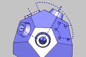

  • Multiaxis Drill
    Multiaxis drilling is used for multiaxis machining (more than three axes), in which the tool orientation may or may not be parallel to the main spindle direction. This drilling type is also used for Mill Turn jobs, for example, when drilling holes on the circumference where the tool orientation does not point to (or cross) the rotation axis of the part (usually the Z-axis).
    Mill or Mill Turn Multiaxis Drilling
    The following images show some example multiaxis toolpath. Note that Multiaxis drilling can also perform standard drilling.
Mill Multiaxis Drilling

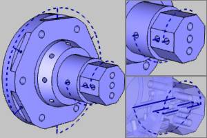

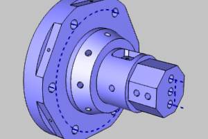

  • Cross Drill
    Cross drilling is only available for Mill Turn jobs, which may be called diameter or radial drilling. This drilling type is used when the tool orientation points directly to, or crosses, the rotation axis of the part, usually the Z-axis. Note that the tool orientation must also be perpendicular (at a right angle) to the rotation axis. On the physical machine, the tool orientation for cross drill holes is parallel to the X-axis.
    Mill Turn Cross Drilling
    The following images show example cross drilling toolpath. Note that cross drilling does not require Y-axis capabilities. Drill holes that require Y-axis movement are not considered cross (radial) drilling and are handled using Multiaxis drilling.
