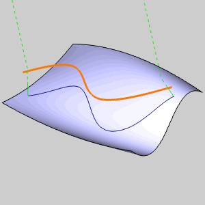

The Project Curves feature is used to create projected toolpaths using either a user-defined geometry curve, offsets of that curve, a radial pattern, or a spiral pattern. When selecting curve geometry directly from a surface, the projected toolpath is identical to the original. When the curve geometry is above the surface there are multiple possible results depending on the scenario and parameter selections. This pattern can be used to create engravings as well as spiral or radial finishing patterns for complete surfaces.

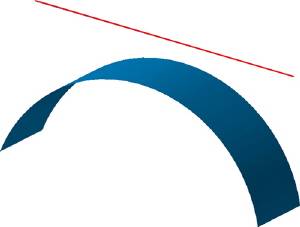

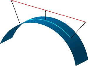

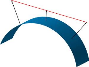

  • A simple curved face with a projection curve (red) above. The curve lies within the max projection distance.

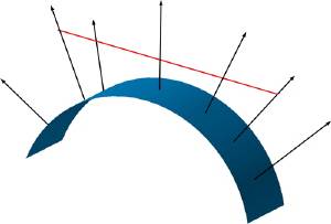

  • For the projection, some surface normals (black) intersect with the curve.
  • Only the intersecting surface normals are used for the projection.
  • The curve projected onto the drive surface.

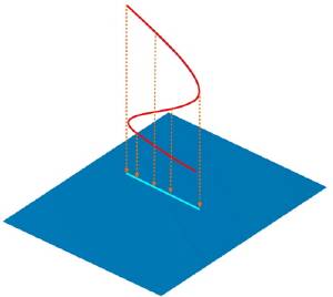

  • A vertical spline curve projected onto the drive surface creates a line.
