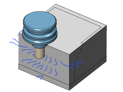

Multiaxis Roughing Toolpath.
Collision avoidance
Check with machining surfaces - The holder will
not be checked against the in machining surface with this method.
Check with machining surfaces - This enables the toolpath calculation to gouge
check the tool and holder against the selected geometry.
Tip: This option is best utilized when the selected geometry is not completely inside of the stock material.
Check with in-process stock - The holder will
not be checked against the in process stock.
Check with in-process stock - This enables the toolpath calculation to gouge
check the tool and holder against the in process stock.
Note: In Process Stock is the stock as it would appear at any point in the operation. As the operation is run, material is continuously being removed. As material is being removed, the stock to check against the tool and holder for gouges is continuously being updated. With this method, the Gouge Checks are run as the toolpath is being generated.

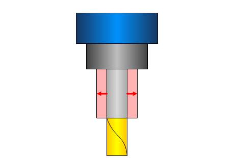

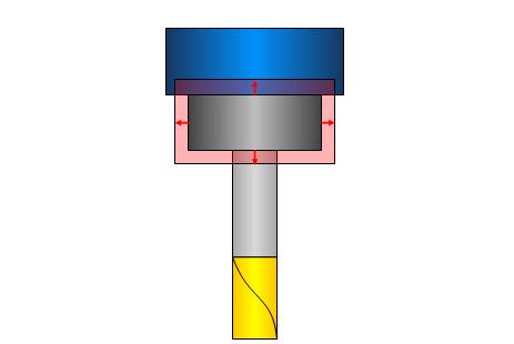

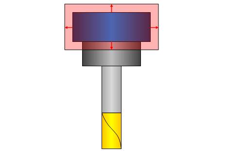

Clearance values
Clearance values allow you to specify individual clearance distances to use on the following components:
- Shaft - sets the clearance to use for the shaft.
- Arbor - sets the clearance to use for the arbor.
- Holder - sets the clearance to use for the Holder.

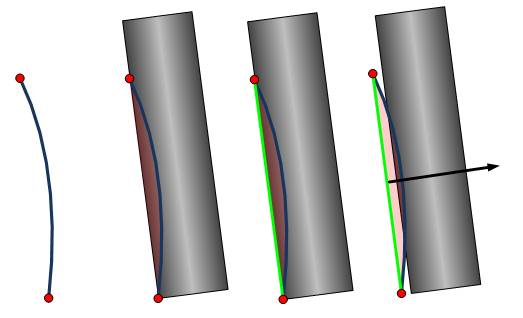

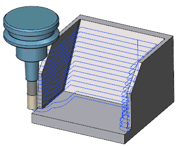

Swarf Machining Toolpath
Gouge Excess
- Check
Guide curves only - ensures there is no collision with the guide curves.
Swarf surfaces - check the chosen surfaces for the SWARF operation. This allows access to the Collision handling options.
Additional surfaces - allows for the selection of additional surfaces to check against.
Swarf & Additional surfaces - checks the surfaces chosen for the SWARF operation, and allows for the selection of additional surfaces to check against.
- Collision handling
Degouge - The degouging will push the tool out of swarf surface in case a collision occurs. To avoid the collisions the tool will be pushed away orthogonal to the contact line between to the upper and lower curve. The user can select the swarf surfaces or any other surface for the degouging. A tolerance sets the accuracy of the degouging.
Balance - The balancing equalizes the amount of rest material and gouging.
Balance within allowance - While the balancing equalizes the amount of rest material and a gouge, the balancing with allowance will try not to exceed the user defined thresholds. In case a threshold will be exceed a warning will be shown.
- Gouge allowance - allows you to assign an allowance to the gouge.
- Excess material allowance - allows you to assign an allowable amount of excess material.
Avoid by relinking
- Check
- - no check is performed.
- Check faces clearance - allows for an amount of face clearance to be used on the check surfaces in case of collision.
Avoid by retracting
- Check
- Direction
Along tool axis - This collision control simply retracts the tool along its tool axis from when a collision is detected. At the colliding area the tool retract along its tool axis. After the collision the tool retracts back to the drive surface.
Along contact line - This option will retract the tool along its contact line with the drive faces. In the colliding area the tool retract along the line to avoid the collision.

- Shaft clearance - sets the clearance to use for the shaft.
- Arbor clearance - sets the clearance to use for the arbor.
- Holder clearance - sets the clearance to use for the Holder.
