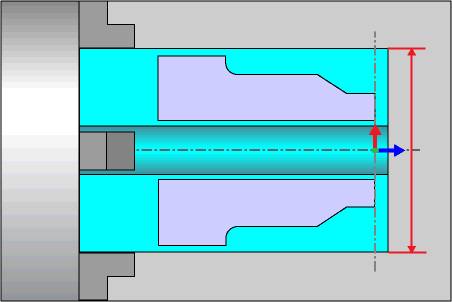

 Stock Diameter
	 - sets the outside diameter of the stock. Stock Diameter

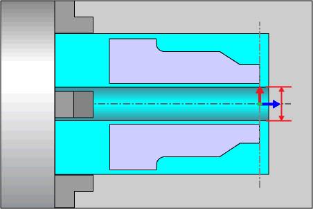

 Internal Diameter
	 - sets the inside diameter of the stock. Internal Diameter

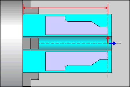

 End of Stock Z
	 - defines the Z-axis value for the back face of the stock (from the
	 machining origin). End of Stock Z
	 machining origin).

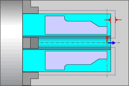

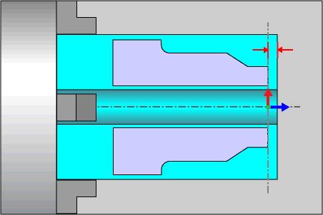

Clearance
 Face -
	 sets the amount of clearance that is applied (in Z) for rapid movements
	 along the stock face. Face -

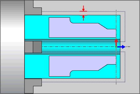

 Diameter
	 - sets the amount of clearance applied (in X) for rapid movements
	 along the outside diameter of the stock. Diameter
