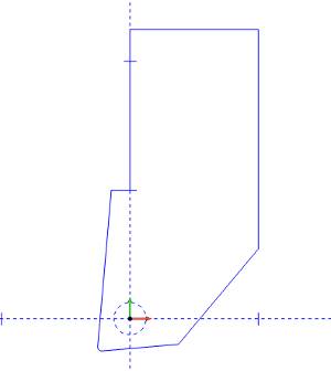

  1. In the graphics area, draw the 2D shape of the holder.
At the position of the attachment point of the tool insert, place a dashed circle.
It does not matter which dashed pattern is chosen, just that the circle itself is not solid.

  1. In the graphics area, click and drag a window around the entire drawing to select the holder geometry.
    The holder geometry is added to the Holder Shape list, while the dashed/dotted Match Circle is automatically added to the Match Circle list.
