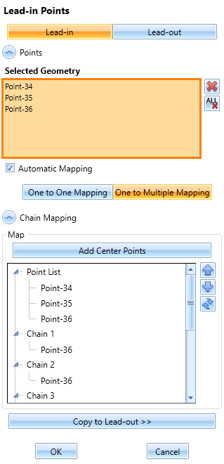

The Lead-in/out Points Dialog
The new dialog allows you to select points to assign to the toolpath chains.
Automatic Mapping - automatically assigns points to the chains.
One to One Mapping - prevents multiple chains from using the same point.
One to Multiple Mapping - allows multiple chains to use the same point.
Add Center Points - assigns each inside chain a center point.
Map - This area lists all selected points and chains and allows manual control:
Drag points to the intended chain
Move points with the up/down buttons
Delete points from their currently assigned chains
Delete points from the Selected Geometry list
Add Center Points to chains

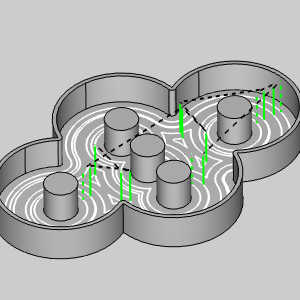

Advanced Pocket - Adaptive - Ramp at Drill Positions
When utilizing the Adaptive pattern of the Mill 2 Axis Pocket operation, many users have begun to realize how they can control the shape of the toolpath by adjusting the start locations with the Drill Tip Positions. The downside to using Drill Tip Positions is that the software assumes there is a drilled hole at these positions, so the tool would always plunge. To give the users the control to adjust the start locations when using the Drill Tip Position points, we have added a Ramp at Drill Positions checkbox so that ramping at this position is now possible! This is only available for the Adaptive pattern.
When using an advanced pocket with a ramp entry, you may want to enter from previously drilled positions in the stock. |
In the past, selecting drill tip positions overrode the ramp entry method and applied a basic plunge entry. |
By selecting Ramp at Drill Positions, you can easily ensure a ramp is still applied to the selected drill tip positions! |

Advanced Pocket - Arc Fit Links
New optimization is used to output arcs when posting Advanced Pocket operations using the S-Link option in the Links page. When the choice is outputting lines or arcs on your machine, the choice is clear. When arcs are output, it requires less code and makes for smoother machine moves. In this version, when you're using S-Links with the Offset Pocket Out, Offset Pocket In, or the Morph Spiral pattern, arcs are automatically output in the code to help for smoother machine moves and reduced code output of 50% or more!
Previous S-Link Toolpath Points (Lines) | New S-Link Toolpath Points (Arcs) |
