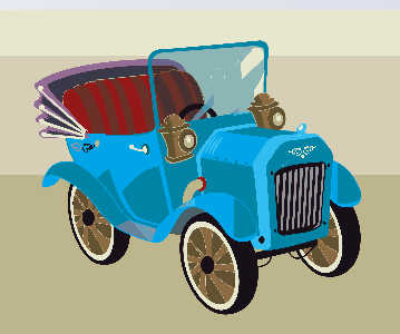

In this example, a color image of a car is used to create vector geometry.The image used is shown next.

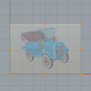

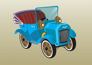

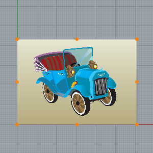

  4. Select OldCar.bmp, and click Open.
    The Load Image dialog opens and the image is loaded and displayed in the graphics area.
    Notice the Image-Old Car item is added to the BobART tree under Images.tree that contains the image (Sketch Picture).
Selecting a location
  1. By default the UCS is set to World Top which is the desired UCS for this example.
  2. The bottom left of the image is placed at the Origin position.

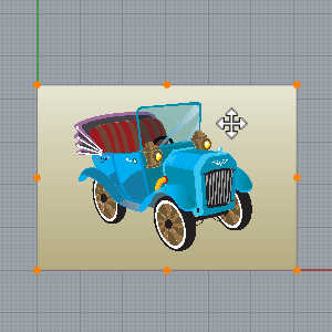

    This can be adjusted by editing the values in the fields, or by placing your mouse over the image and dragging it into the desired position.
    For this example, we leave the origin at 0 for all values.
  3. If needed we can add a rotation angle to the image, but keeping the edges parallel with the X and Y axis is the desired result in this case, so this value is left to 0 as well.
Setting the size
  1. The current size of the image is listed as:
    1. X Size = 303.699
    2. Y Size = 216.662

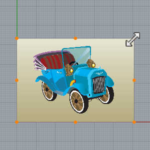

  1. These values can be updated by adjusting the values in the fields directly, or by using your mouse in the graphics area to pull the given points in the desired direction.
    In this case we will leave the size as it is, but adjusting one of these values with either method automatically adjusts the other to keep the aspect ration of the image.To adjust a single value independently, clear the Keep Aspect Ratio check box.
Setting the Transparency
  1. To adjust the transparency, in the Transparency group at the bottom of the dialog, select Full Image and either adjust the slider, or set the value between 0 and 1.
    In the images below you will see the a value of 0, followed by a value of 0.75.
    In this case we will leave the Transparency at 0.
  2. Ensure the Transparency is set to 0, and click OK.

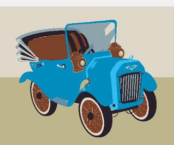

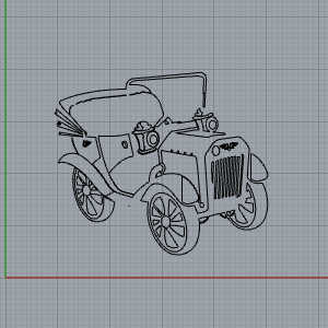

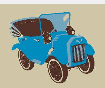

The Multi-Color Strategy
In this section we begin using the multi-color strategy to vectorizethe image and begin exploring the various workflow options for creatingand saving geometry.
  1. In the BobARTtree, right-click Image-Old Car, and click Vectorize.
    The Vector... dialog is displayed.
  2. In the Method group of the Strategy section, click Multi-ColorStrategy.
    The image is shown divided into 64 specific colors.The multi-color strategy defaults the number of colors to 64, whichallows you to target very specific colors or color ranges in the imagein order to be more precise with the vectorization results.Experimentationwith the number of colors is an important aspect of learning to vectorizeimages in an efficient manner.
  3. Next to #of Colors, click the down arrow and select 64.
  4. At the bottom of the Parameters group, under the color boxes, click CheckAll.
  5. Click Apply to vectorize the image in its current state.
  6. Next to #of Colors, click the down arrow and select 32.Notice the change in the preview.For example, the gradient of theimage background is reduced from 6 unique colors to 5, and the yellowand orange colors are removed from the head lights and the exhaust.
    When you change the number of colors, the image is actually reducedto the selected number of colors, and the color boxes update underColors to be Vectorized.
  7. Continue reducing the #of Colors (for example to 16, 8, and 4), and observe the changein the preview.
  8. Change the #of Colors to 24 andclick Check All to automaticallyselect the check box of all colors.
  9. Click OKto vectorize the image.

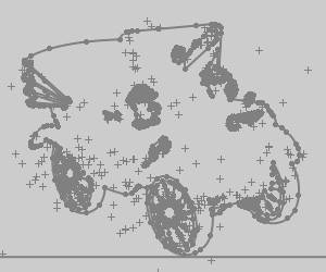

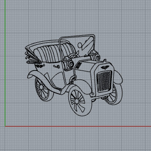

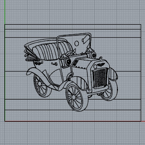

    The image is processed using all 24 colors to createthe vectorized geometry.Notice the horizontal lines.This is a resultof the gradient in the background of the image.The current settings separatedthe gradient into three unique colors.
    Although it is not the method used for this tutorial,you could decide that you are now done with the vectorization and simplyedit the geometry.Depending on what you want to achieve, this may notbe the most efficient method to use.When using this method, you are vectorizingmany adjacent colors, which results in a large amount of entities.Regardlessof how you choose to work, we explore another important parameter next,Remove Chains Less Than.

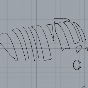

    Notice that the geometry from the first vectorizationis removed and replaced with new geometry.
    When there is geometry that you want to keep, youcopy it to a new layer.This allows you to vectorize the image more thanonce (in order to be more precise).

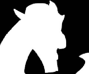

Part 6) Use the Black and White Strategy
The 2 Level Black and White Strategy
This section explains how the Vectorize... dialog is used tocreate and modify the vectorized geometry.We start by experimenting withthe 2 Level Black and White strategy, as it is a viable option for vectorizingcolor images or black and white images.The strategy simply determineshow the image is analyzed in order to create geometry.

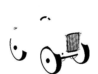

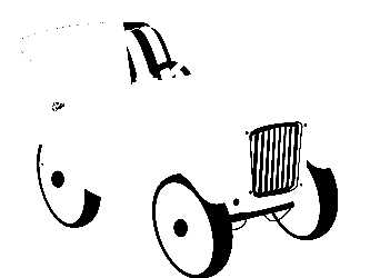

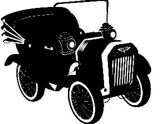

    The Vectorize dialog displays and the image appears in blank and white with only portions visible.
    This is because in the Strategy section, the Method is set to 2 Level(Black/White) Strategy by default.
  2. In the ThresholdValue field, update the value to 40.
    No noticeable change occurs.
  3. Update the value again, but this time, use 60.
    Notice the preview of the image updates each time that you change thevalue.
    You can also click and drag the Threshold Value slider, in small increments,and release (to accomplish the same task).
  4. Change the Threshold Valueto 140.
  5. Click OK to vectorize the imageand update the original sketch feature.
    Hide the image to view the geometry.
    The resulting geometry is placed on the active layerautomatically adds to the SolidWorks Feature Manager design tree.It is important to understand that when you edit the Vectorizationparameters in the Vectorize... dialog, the previous resultis replaced.This allows you to experiment with the vectorizationresult without creating excessive features or geometry.

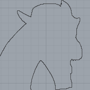

  7. Change the ThresholdValue to 174 and clickOK to update the vectorizationresult.

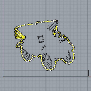

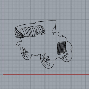

For this part, you experiment with the Black and White strategy to getthe profile of the car.
  1. Select the outer profile as shown next.
  2. In the Command Line type CopyToLayer and press Enter.
    The Layer to copy objects dialog appears.
  3. Select Profile and click OK.
  4. Hide all but the Profile layer.
    The geometry should appear as follows.

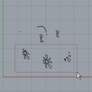

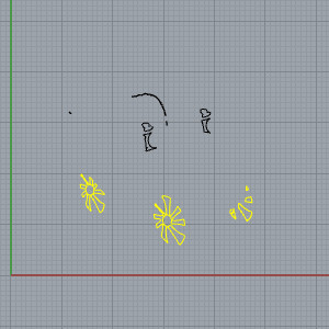

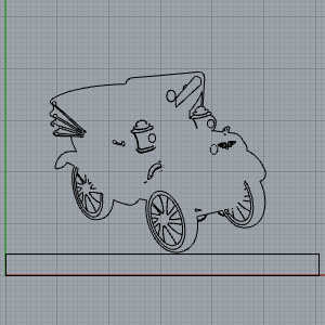

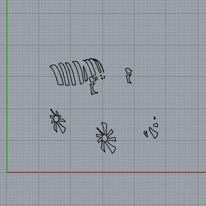

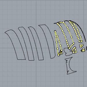

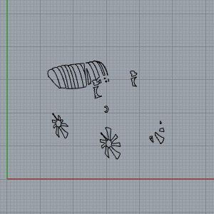

  5. When you zoom-in to view the front wheel,you can see that there are small unwanted entities as shown next.
Part 8) Remove Chains Less Than
The Remove Chains Less Than parameter is very important when vectorizingimages, as it helps you to remove unnecessary geometry that may be createdfrom the gradients in an image.
  1. Show the image, and zoom-in closely to differentareas of the image and notice the geometry as compared to the selectedcolors (gradients).For example, the grill on the front of the caror the wheels are a great place to view how the geometry is createdbased on the colors.

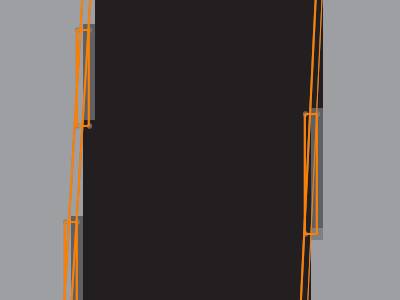

    The following image shows the colors of the front grill zoomed in closelywith the geometry hidden from view.You can see that there are actuallythree colors that make the vertical black and gray stripes.
    Because we have vectorized all 24 colors, the software created geometryfor each color.The first point here is that you may not want to vectorizeadjacent colors, as it results in what appears as duplicate geometry,although it isn't.It may be better to vectorize only one of the colors.The second point is that the darker gray color results in very smallentities that are most likely not needed.The geometry from our vectorizationis shown next highlighted to make it easier to view.

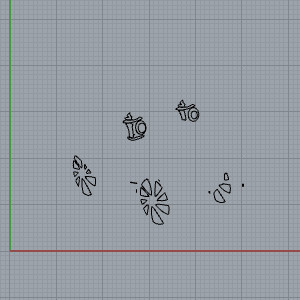

    You can see the small rectangles are not needed, so now we use theRemove Chains Less Than parameters to remove them.
  2. Right-click Vectorization,and click Edit.
  3. Under VectorizeParameters, change the RemoveChains Less Than value to 75(pixels), and click OK.
    You can see that the small groups of entitiesare now removed from the result.You can experiment with the Remove ChainsLess Than value to make the vectorization result more efficient.Nextwe explore more ways to be efficient with vectorization.

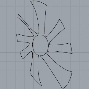

  4. In the graphics area, click and drag a window around the three wheels asshown next.

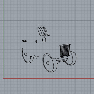

  5. Copy the selected geometry, to the Wheels layer.(Useeither method as explained earlier.)
  6. Hide all but the CAD layer and set it as the active layer.
Note: To getthe other contours from the wheel, the following color is used.
The Remove Chains Less Than value was changed to100, to create the following result.
Be sure to reduce the Remove Chains Less Than value(if needed) when moving on to vectorize a new area of the image.

    The result is grabbing mostly the brown areas of the seat.
  8. Select the desiredgeometry, and copy it to the SeatBrowns layer.
  9. Copy the red areas of the seat to the SeatReds layer.
  10. Edit the parameters, and select the following colors.
    Click OK.
    This time mostly the red areas of the seat are vectorized.
    Show and hide the image to compare.
  11. Copy the desired geometry to the SeatReds layer.
    The brown areas of the seat are copied to the SeatBrowns layer.
    All of the geometry created so far is shown next.
  12. Continue this process until you have createdall of the desired geometry from the image.
(Pick a target area.Adjust the Number ofColors to create the desired results.Copy the geometry to a new layer,and repeat.)

You can change the location of the image in the graphics area using theImage Origin dialog.
To change the image location:
  • Right-click Image-name, and click Edit.
  • Set the Origin values (inrelation to the WCS or world coordinate system).The Origin of theimage is the lower-left corner.
  • Click OK.The image ismoved.
  • To move any vectorized geometry to the new location, open the Vectorize... dialog, andclick OK.
Warning: Only the original geometry associated to the image, and not copies of the geometry will be updated using this method.
Moving the image is helpful when you vectorize more than one image.
