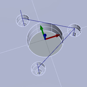

Part 3) Add a Counterbore Hole Feature and Select Geometry
  1. In the CAM Tree, right-click Stock and select Blank/Unblank to hide the stock.
  2. Right-click Machine Setup, and click Mill Counterbore Hole.
    The Hole Wizard displays.

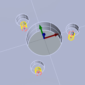

  3. Click Select Geometry.
  4. Click to select the cylindrical faces of each of the three counter bore holes as shown next.
  5. To confirm the selection, click OK.
When you select the geometry for a Mill Counterbore Hole feature, the software extracts all applicable features and creates a separate feature for each unique hole size.
Tip: After inserting a Counter Bore feature, you can modify the assigned feature geometry by right-clicking Geometry and clicking Re/Select from the CAM tree. You can also click the Geometry item to highlight the selected geometry in the graphics area.
