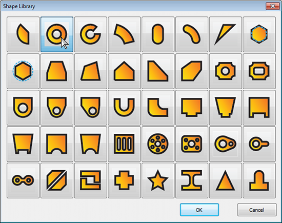

1      In the Other menu, click Shape_Library_Icon.bmp Shape Library.
Select the Shape_2_Ring.bmp ring shape, and click OK.
