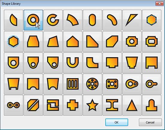

We use the Shape Library to quickly create wireframe geometry that is modified later.
1 In
the Other menu, click
Shape
Library.
Select the
ring shape,
and click OK.
2 In
the
Data Entry
Manager, update the parameters as follows:
1 = 4.000
2 = 2.250
Notice that the CAD preview of the shape updates as you define the Data Entry parameters. The CAD preview allows you to confirm the desired result before creating the shape.
Under Position and Orientation:
X = -2.000
Y = -2.000
3 Click OK to create the shape.
4 Click Cancel to close the Data Entry Manager.
