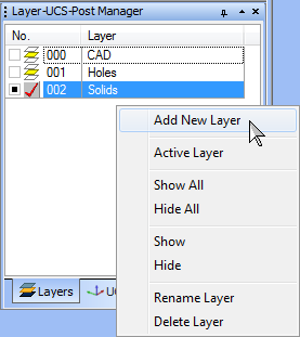

Before creating our milling job, we create a rectangle that represents our stock boundary which is also the geometry for a facing operation. We then use this rectangle in the Stock Wizard as an alternative way to offset the stock size.
1      Right-click
 in the
 Layers Manager,
 and click Add New Layer.
2 To name the layer, type Facing, and press Enter to finish.

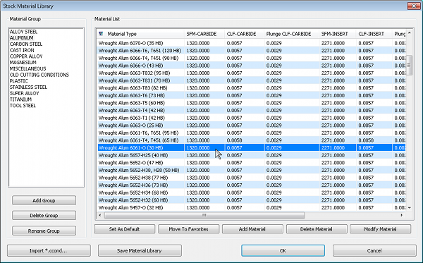

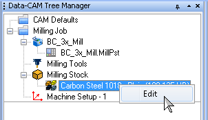

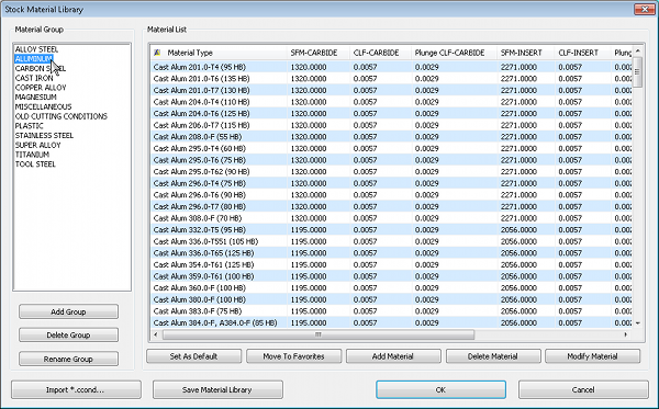

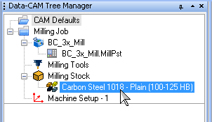

Selecting the appropriate stock material for the job determines the values used for automatic speeds and feeds calculations in the Milling Wizard. This information can be customized using the Stock Material Library.
1      In
 the
 CAM Tree, right-click the current
 Stock
 Material, and click Edit.
2 Under Material Group, select Aluminum.
3 In the Material List, click Material Type to sort the list, and select Wrought Alum 6061-0, and click OK.
