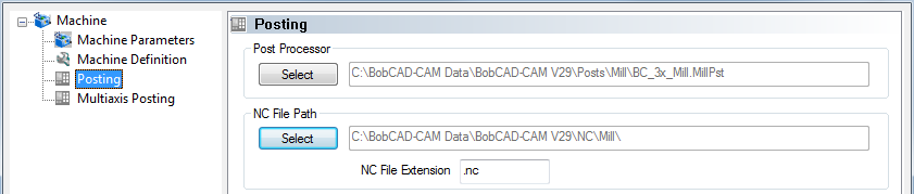

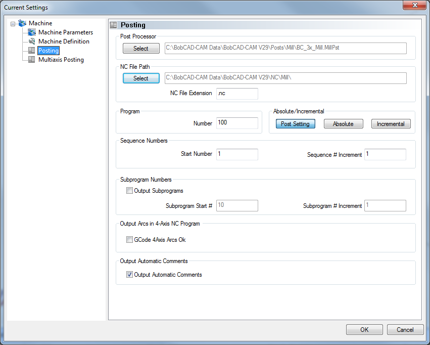

After simulating and confirming the desired result, you are ready to post the NC program. It is important to understand that the NC program is created using the post processor file that is assigned to the machine. The default post processor for each machine is defined in Current Settings and can be modified from the CAM Tree.

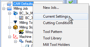

How to Access Current Settings
To open the Current Settings dialog box:
TIP:   This method selects the Current Settings Default (for system default settings). You can also access the Current Settings Job (for the current job only) by right-clicking Milling Job instead of CAM Defaults.
Many important Posting settings, such as the program number, subprogram selection, and more are defined in the Current Settings. For more help, view the BobCAD-CAM Help System.

This option creates the NC program in the location defined in Current Settings.
This option allows you to specify the name and location to which the NC program is saved.

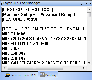

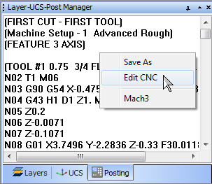

When you post a program in BobCAD-CAM, the NC program also displays in the Post_Processor_Icon.png Posting Manager.
The Posting Manager allows you to view the code, and you can open it in the NC Editor.
The NC Editor and RS232 Communication (DNC)

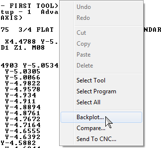

To edit the NC program:

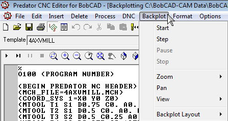

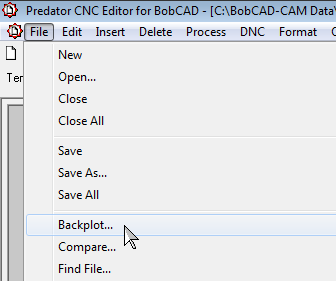

This launches the editor with the NC program. The editor allows you to edit the code, setup RS232 communications (DNC), and even backplot the program (Editor Pro), which allows you to simulate exactly what the code is going to do on the actual machine.

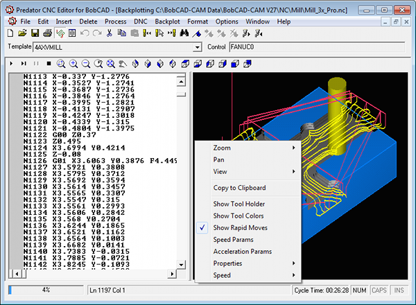

How to Backplot in Editor Pro
The pro editor contains some advanced functionality that isn't available in the standard editor, such as syntax highlighting and backplotting.
To backplot an NC program in Editor Pro, do one of the following:
The Backplot menu then displays, which contains the start, stop, pause, and other controls used for backplotting.
Note that you can right-click in the backplot (graphics) window while it is running to access more options.
