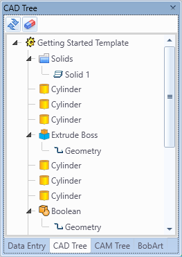

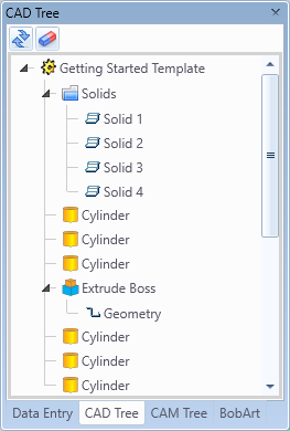

    Notice that there are three Solid items in the Solids folder of the CAD Tree. You can click each Solid item to highlight the solid in the graphics area.
  13. Press Ctrl+S to save the file.

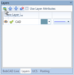

Part 4) Create a New CAD Layer
Using layers is a great way to keep your CAD files organized. One successful method is to place wireframe geometry on one layer and solid geometry on another layer. This is helpful for hiding, showing, and selecting geometry.
  1. Click on the Layers tab to show the Layer Manager.
  2. In the quick selection toolbar of the Layer Manager, click the icon to add a new layer.
    A new layer, Layer-1, is created.
    It is automatically set as the active layer, and the name is highlighted to allow for edits.
  3. To name the layer, type Wireframe.

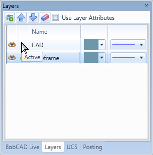

Part 5) Create an Arc

  5. In the Layers Manager, click in the CAD row of the active column to set it as the active layer.

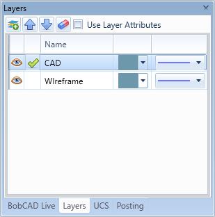

  5. Click Cancel.
    Notice that the Solids folder now contains only one Solid item.
    The Extrude Boss function merges all intersecting solids into a single solid body.
  6. In the Wireframe row of the Layers Manager, click the icon to hide the Wireframe layer.

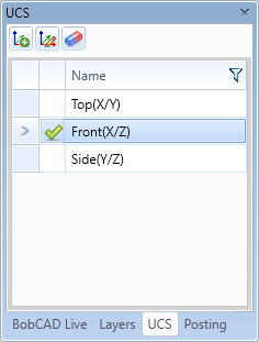

Part 7) Change the Active UCS
We create the next set of solid primitives using the front plane.
  1. In the UCS Manager, click Front (X/Z) to make that the active coordinate system.

    Notice that there are now four Solid items in the Solids folder.

  1. In the Solid Boolean group, of the Create 3D ribbon, click the Boolean icon.
    Verify the Type is set to Add.
  1. Click the longest cylinder first (the solid created with Extrude Boss).
  2. Select the last three cylinders to add them to the list.
    The solid updates, and the Boolean feature is added to the CAD Tree.
    Check the Solids folder and notice that we now have one Solid body.

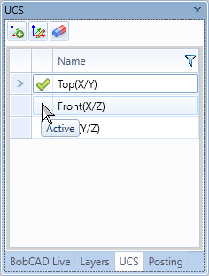

Part 10) Change the UCS
  1. In the UCS Manager, click Top (X/Y) to set it as the active coordinate system.

  1. In the Document Toolbar, click Select Mode to enter selection mode.
  2. In the Selection Mask toolbar, in the graphics area, click Solid Mask to remove the ability to select solids.
  3. Drag a window to select all of the geometry.
    Only wireframe geometry is selected.
  4. In the Modify group, of the Home ribbon, click Modify Layer.
  5. In the Select Layer dialog box, click Wireframe.
  6. Click OK.
  7. Save the file.
