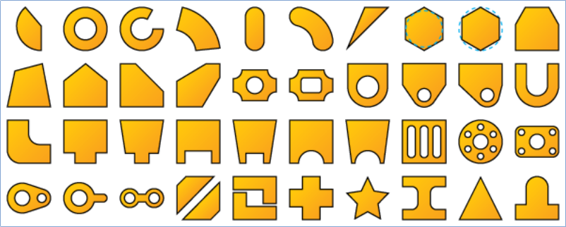

  1. In the Shapes group of the Create 2D ribbon, click Shape Library.
    The Data Entry Manager is populated with the data for the default shape.
  2. Click the image of the Disk shape in the Data Entry Manager.
    A dialog presenting the available shapes appears.
  3. Select the ring shape.
    The Ring parameters open in the Data Entry Manager.

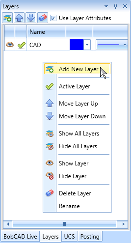

  1. Select the check box for Use Layer Attributes in the quick access toolbar of the Layers Manager.
  2. Right-click in the Layers Manager, and select Add New Layer.
    A new layer is created with the name, Layer-1, highlighted to allow for edits, and is set to the active layer automatically.
  3. To name the layer, type Outer.

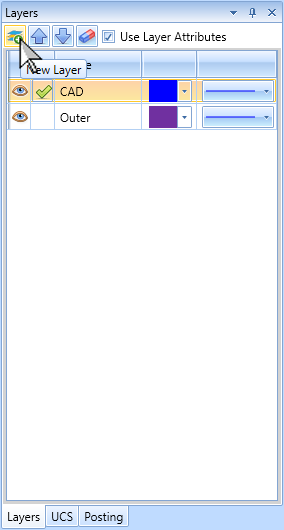

  1. In the quick access toolbar of the Layers Manager, click the New Layer button.
    A new layer is created with the name, Layer-2, highlighted to allow for edits, and is set to the active layer automatically.
  2. To name the layer, type Holes.
    The name is automatically updated once focus is placed on another area, or function.
