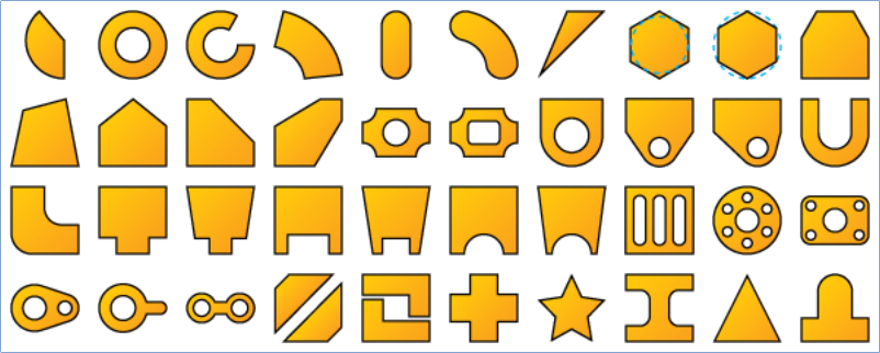

  2. Click the image of the Disk shape in the Data Entry Manager.
    A dialog presenting the available shapes appears.
  3. Select the Inverse Fillet Rectangular Hole shape.

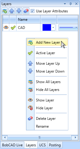

  1. Right-click anywhere in the Layers Manager, and click Add New Layer.
    A new layer is created with the name, Layer-1, highlighted to allow for edits, and is set to the active layer automatically.
  2. To name the layer, type Holes.
    The name is automatically updated once focus is placed on another area, or function.

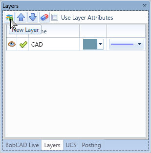

  1. In the quick access toolbar of the Layers Manager, click the New Layer button.
  2. Type Pocket to name the layer.
  3. Create another layer and change its name to Solids.
