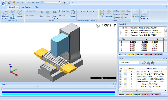

How to Launch Simulation
The Simulation tab of the ribbon bar contains many of the most used commands in simulation as explained next.
Simulation Control
The Control group of the Simulation tab is used to navigate the program simulation. This includes the run, stop, next operation, and restart buttons. The speed slider of the Simulation Run Speed group controls how fast or slow the simulation runs.

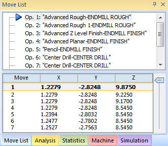

Move List
The Move List contains a list of all operations and the tool moves for each operation. You can click an operation to go directly to that part of the program simulation. You can also drag the slider to go forward or backward in the simulation.

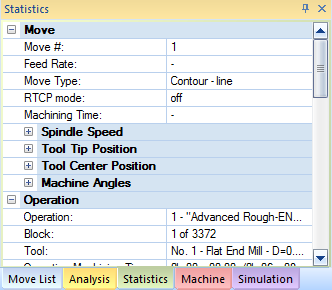

Statistics
The Statistics provide important information about the current move, operation, or all operations, such as the feedrate and cycle time.

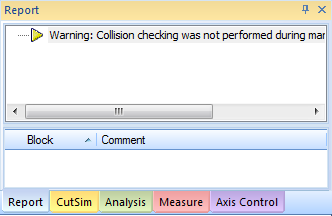

Report
The Report provides useful information about collisions that occur during the machining process, for example, a warning that manual position changes were not collision checked.

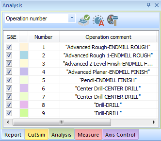

Stock Analysis
The Stock Analysis allows you to apply a coloring scheme to the stock model. For example, the cut stock material can display based on the operation number, tool number, or other criteria such as height change, angle change, or toolpath length. You can also perform deviation analysis to visualize the rest material.

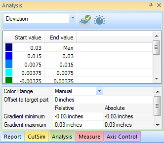

Deviation
The Deviation analysis allows you to compare the cut stock model to the target workpiece. You can set the range, gradients, number of colors, and even customize the colors used.

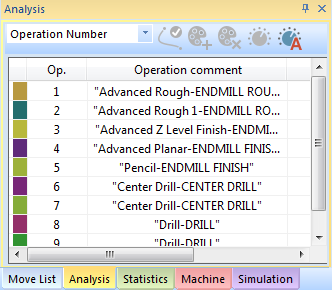

Operation Number
The Operation Number analysis displays all cut stock material with a separate color for each operation.

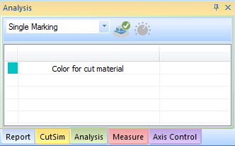

Single Marking
The Single Marking analysis displays all cut stock material using a single color.
