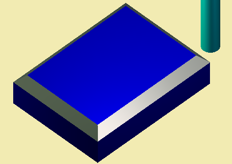

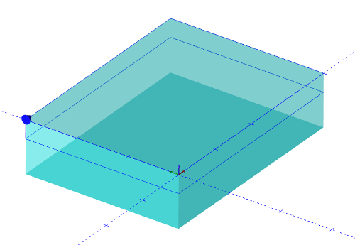

This operation type is used to place a chamfer around any 2D profile. When a Chamfer Mill feature is added to the CAM tree, the system also adds the following items.
Start Point - Allows you to specify a location for the tool movement to start. Right-click this item to produce a shortcut menu with the following options.
Re/Select - Select this option to enable selection mode and assign the appropriate start location to this feature.
Remove - Select this option to remove any start point associated with this feature.
