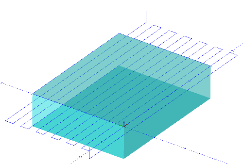

This operation is used to face off a block of material and provides controls for leads and operation parameters. When a Facing feature is added to the CAM tree, the system automatically adds the following items.
