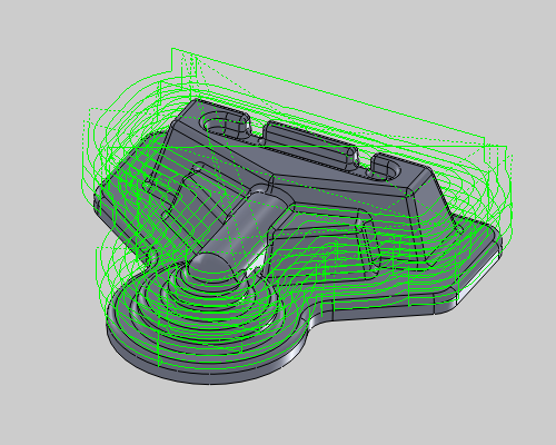

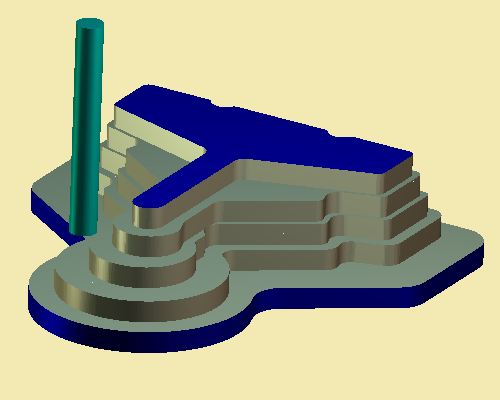

View the following illustration for an example of the toolpath produced.
