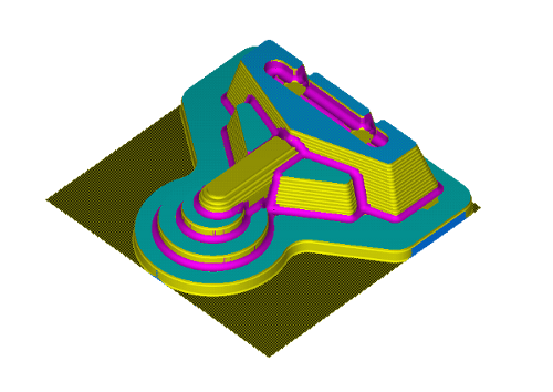

After simulation, the resulting pencil toolpath is shown in pink next.
