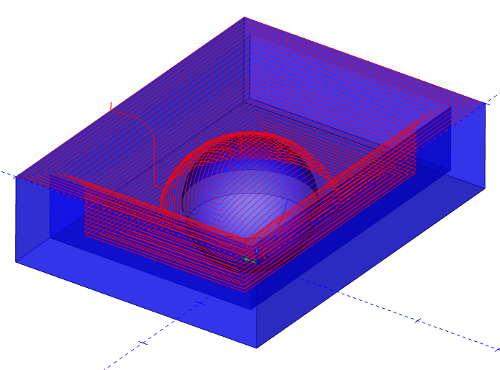

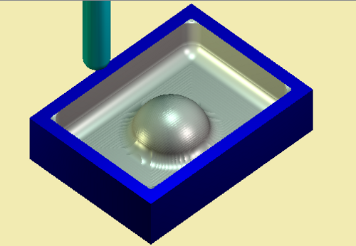

The Equidistant Offset 3-axis toolpath is available in the BobCAM PRO upgrade.
Using the outer contour of the selected surfaces, solids or STL data, the system offsets the contour and generates an equidistant toolpath on the model. This operation is excellent for finishing as the scallop left on the material is always consistent, even on vertical or flat areas. This operation is very calculation intensive and takes the longest time to run of all the 3D operation types, but also leaves the best finish. When an Equidistant Offset feature is added to the CAM tree, the system adds the following items.
