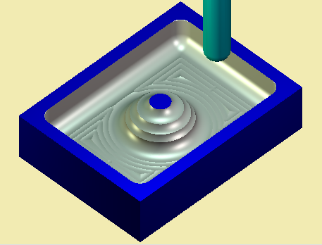

Used to remove material with successive pocketing passes while taking the topology of a 3D Model into account. Sometimes referred to as water line roughing, material is removed in a series of defined steps in a by-level or by-area processing pattern, leaving material for separate semi-finishing and finishing processes. When a Z-Level Rough feature is added to the CAM tree, the system adds the following items.

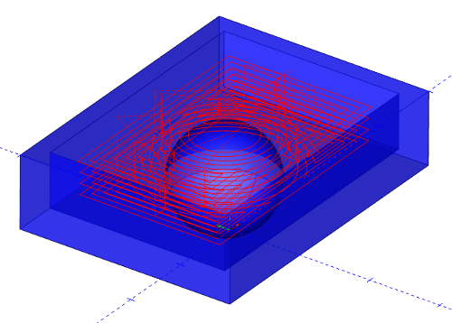

View the following illustration for an example of the toolpath produced.
