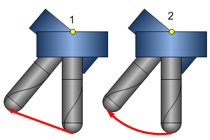

NOTE: The machine simulation always supports RTCP kinematics for collision checking.
(Picture 1-RTCP enabled; Picture 2-RTCP disabled)
