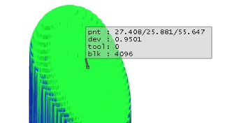

Points
The point gives information about the current coordinates X, Y and Z, the tool being used, block number and the deviation.
Move the pointer onto the stock. Then double-click with the middle mouse button. A point is shown in a small text box in the simulation window. The point is added to the point list.
The information in the text box:
In case the point is set on deviation colorization, a fourth element is added to the point information:

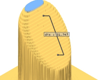

Distance - The distance measures the 3D distance between two points on the stock model.
Move the cursor onto the stock. Then double-click the middle mouse button to select the start point and an end point. A distance value is shown in a small text box in the simulation window. The item is also added to the distance list. The information in the text box is the 3D distance between the 2 selected points.

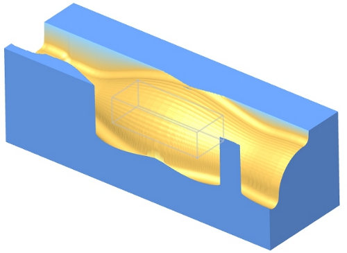

Zoom Box - Use the zoom box to zoom into a certain area of the stock model. The material around the zoom box is removed, thus using the full resolution for the zoomed area.
Move the cursor onto the stock. Then double-click the middle mouse button to select the start point and an end point of the zoom box.
Click Zoom In ZoomInIconSim.jpg to activate the zoom. You can also repeat the zoom onto the new area as well.
Click Zoom Out ZoomOutIconSim.jpg to get to the previous zoom stage.

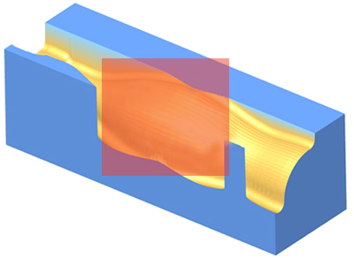

Dynamic Zoom - Use the dynamic zoom in a certain area of the stock model. The material, except the portion which is visible on the screen, is removed. This area is then calculated with a higher resolution.
Zoom into an area on the part (indicated as red area). Use the mouse wheel.
Click Zoom In ZoomInIconSim.jpg to activate the zoom. Note that you can repeat the zoom onto the new area as well.
