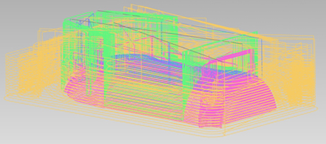

The toolpath analysis applies colorization schemes onto the rest material which allows you to analyze the toolpath.
Tool Number - The toolpath is colorized after the different tools being used.
Main benefit
Identify the amount of different tools being used.
Identify the area a certain tool is performing a machining.
The following picture shows a machining of a bottle. The toolpath is colorized after the different tools being used. As you can see there are four different tools being used.
Operation Number - The toolpath is colorized after the different operations being used.
Main benefit
Identify the amount of different operations.
Identify the area a certain operation is performing a machining.
The following picture shows a machining of a bottle. The toolpath is colorized after the different operations being used. As you can see there are four different operations.

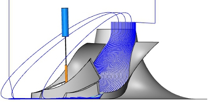

Rotation Axis Value Change - The toolpath is colorized after the tilt angle of one (A,B or C) of the machines rotation axis value changes.
Main benefit
Identify the rotation speed range being used.
Identify under which rotation speed a certain area is machined.
The rotation speed gives feed back where machine speed limits are reached and where you can expect stability issues of the process which influences the final surface quality.
The following picture shows a machining of an impeller. The colorization is from green (low rotation speed) to blue (high rotation speed). You see that especially in the upper segment the speed is high. At the end and the beginning of the hub the rotation speed is slow.

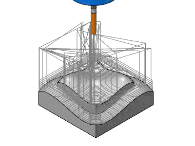

Collisions - The toolpath is colorized after collisions status.
Grey means that the toolpath is not yet checked.
Green means that the toolpath is checked and collision free.
Red means that the tool is colliding with the geometry.
The following animation shows a machining of a random surface. You see the toolpath changes from grey (not checked) into green (checked and collision free).

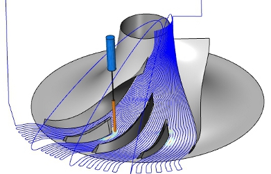

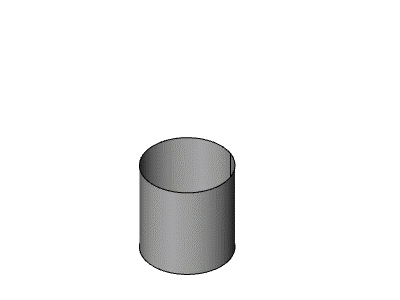

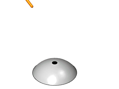

Feed Rate - The toolpath is colorized after the feed rate.
Blue means that the toolpath has machining feed rate.
Yellow means that the feed rate is rapid rate.
The following animation shows a machining of a cylinder. You see the first entry and the last exit have travel with rapid feed rate.

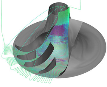

Tool Axis Change - The toolpath is colorized after the tilt angle of both machines rotation-axis value change.
Main benefit
The following picture shows a machining of an impeller. The colorization is from green (low rotation speed) to blue (high rotation speed). You see that especially in the upper segment the speed is very high. At the end and the beginning of the hub the rotation speed is slow.
