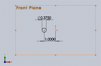

To accomplish this we can start out with a sketch of a circle located on the front plane. In this example the 0.375 inch diameter hole is located at the center of the cylinder, 1 inch from the face of the part.

In order to have the system perform an index, navigate to the Posting page inside of the Hole feature. On this page, select the Output Rotary Angle check box and type 0 in the Rotation Angle box. This outputs the appropriate rotation code for 0 degrees inside of the posted NC program.
Create 2 more Hole features by repeating the previous steps. This time type a rotation angle of 120 degrees in the second feature, and an angle of 240 degrees in the third feature. A program is now ready to post that will center drill, drill and chamfer 3 holes at 0, 120 and 240 degrees around the piece of material.

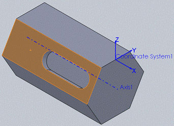

Next, right-click Index System and click Re/Select.
The Selection Manager appears, and by selecting a planar face of the model, BobCAM automatically calculates the rotation angle for this face.
NOTE: The angles are calculated based off the assumption that the positive Z direction of the assigned Coordinate System is the 0 angle.
Select the face shown next and click OK.

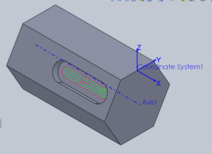

Now that the Index System has been configured, right-click Index System and click Mill 2 Axis, Pocketing. This adds a Pocketing feature to the CAM tree below the Index System.
NOTE: It is important to right-click Index System when adding the milling feature to assure that the angle calculations are included in the machining feature. Adding a milling feature by right-clicking Machine Setup or Milling Tools does not include the rotation angles in the feature.
Next, assign the face of the pocket floor to the Pocketing feature, and modify the parameters as needed. After setting up the Pocketing feature, calculate the toolpath, and the result should look like the following image. Here an Offset Out pattern has been used at one depth of cut. Notice when editing the feature, that the Output Rotary Angle check box is automatically selected and the corresponding angle has been entered.

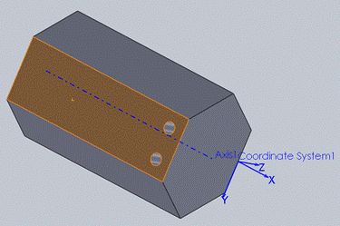

Now that the machining at this index location is complete, another Index System needs to be added to the CAM tree to tell the system a new rotation needs to occur. If more machining were required at this specific index location, just continue adding milling features to the appropriate Index System. Right-click Machine Setup again and click Add Index to create another Index System in the CAM Tree.
Assign the next planar face, where machining needs to occur, to the newly created index system. Shown next is the face select for the hole drilling that needs to occur.

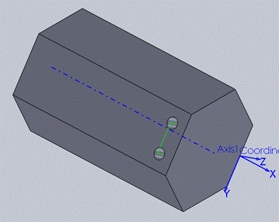

Again, right-click the new Index System and click Drill, Hole to add a Hole feature to the corresponding Index System.
Assign the two cylindrical faces on the inside of the holes, in the model, to the Hole feature, and the diameter and depth are automatically set inside of the Hole feature. Again, the Posting page can be reviewed, and the Output Rotary Angle is selected and the new rotation angle is assigned. Finish the machining feature by computing the toolpath.

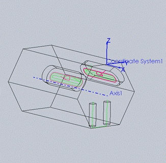

The same steps can be repeated, for the 3rd index that needs to occur, to cut the last pocket in this model. After setup and computing, the finished part should appear as follows.
