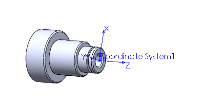

In order to define the zero location on the part, right-click (click with the right mouse button) MachineSetupIcon.png Machine Setup and click Re/Select.
Step 4
Click Coordinate System 1, which has already been created and click OKCheckmarkIconWhite.png OK.

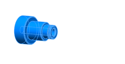

Roughing and Finishing the OD
Step 1
Right-click MachineSetupIcon.png Machine Setup and click Turn, Rough.
Step 2
Right-click GeometryIcon.png Geometry and click Re/Select.
Step 3
Click the Select whole bodies check box and select the part in the graphics area.
Make sure that the Primary region only check box is selected to ignore the groove.
Also, make sure the Remove first vertical line and Remove last vertical line check boxes are selected because the part is already faced.
Click OKCheckmarkIconWhite.png OK.
