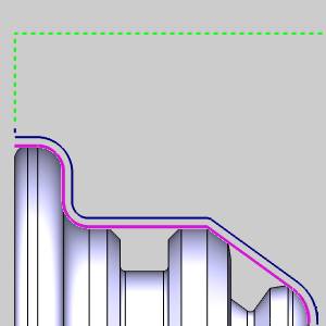

The parameters section give you control over the allowances, if any, that are left on the selected geometry
Finish Allowance - will allow you to leave material on the workpiece to be handled by another finishing pass. Setting values for the Finish Allowance will leave the last pass of this operation offset from the selected geometry by the amount entered in the available Z and X boxes.
Z
- sets the amount left in the Z direction for the finish.
No |
Finish Allowance |

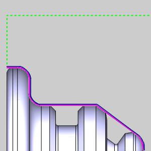

Corner Type
Round - keeps the specified tool
geometry in contact with the geometry at all times.
Sharp - allows the tool to move
off the geometry in order to line up with the next move on the following
entity. This method eliminates the rounding over of the tool.
Theoretical Point on Tool |
Rounded Corner |
Sharp Corner |

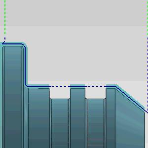

Bounds
Trim to Stock -
With this option selected, the toolpath that extends beyond
the Operation Stock will be trimmed away.
