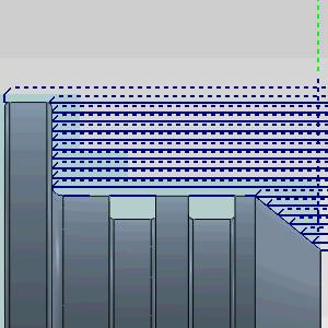

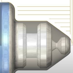

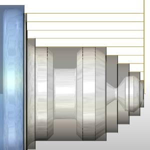

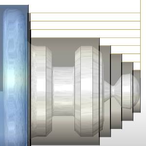

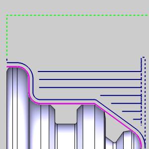

Finish Allowance
- will allow you to leave material on the workpiece to be handled
by the finishing pass. Setting values for the Finish Allowance will leave
the last pass of this operation offset from the selected geometry by the
amount entered in the available Z and X boxes.
Z
- sets the amount left in the Z direction for the finish.
No Allowance |
Finish Allowance |
Rough & Finish |
No Allowance Simulation |
Finish Allowance Simulation |
Rough & Finish Simulation |

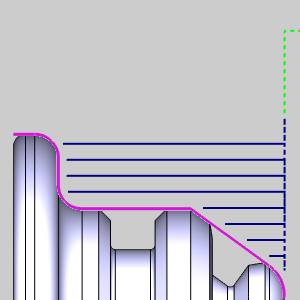

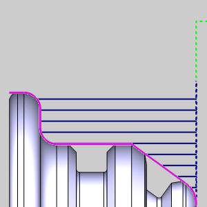

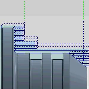

Overlap
The Overlap options allow you to create an additional move prior to the link to the next pass. This link will track back up the geometry in order to eliminate stair steps as seen in the images above. Overlap is controlled with either, To Previous Cut, No Overlap, or Custom Distance.
To Previous Cut - automatically
tracks back up the geometry the distance of the selected depth of cut.
No Overlap - does not track back
up the geometry at all.
Custom Distance - Allows you to
enter a custom distance value. This value is a vertical distance. Entering
the same value that has been entered for the depth of cut will track back
to the last cut exactly.

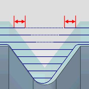

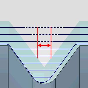

Chip Break
The option allows you to create minute retract moves, at user specified intervals, to aid in chip breaking.
Chip Break... - With this option cleared, the toolpath will not include chip break moves.
Chip Break... -
With this option selected, the toolpath will include chip break moves that can be modified in the Chip Break dialog. Click the Chip Break button to enter the dialog.
This group allows you to determine how the intervals between retracts should be defined.
Length of cut - The retracts are determined by the amount of space between them.
Time - The retracts are determined by the amount of time between them.
Length of chip - The retracts are determined by the amount of material being removed between them.
Retract
- Retract distance - sets the length of the retract move used to break chips.
