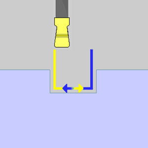

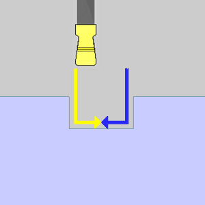

Force Down Cutting - selecting
this option will force the finish to be cut from each side of the groove
one at a time, each in a downward direction, to the middle of the groove.
Adding an overlap will set each pass to go past the center of the groove
half the specified amount.
Overlap - sets the total distance between the two passes exits, not including any leads that are uses.

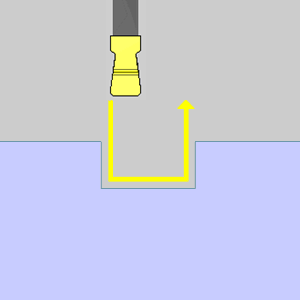

Basic Finish |
Force Down Cutting On |
With Overlap |
Basic Finish - breaks the finishing
pass into separate groups defined by either vertical faces, turned diameters,
or a combination of the two.

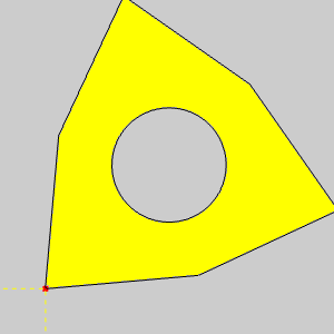

Each tool has a theoretical point placed on it as seen in red in the animation below. In the case of tools with a radius of any size, this point is not actually on the tool, but on the horizontal and vertical intersections of the radius. It is this point that the toolpath plots out. When compensation is used, it is designed to place the actual tool and not just its theoretical point on the geometry. This can be accomplished with System Compensation, Machine Compensation, or a combination of the two.
