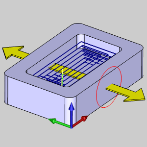

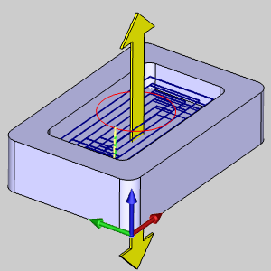

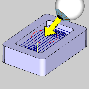

Usage - determines how the Trim Boundary is used. This gives you the ability to alter the direction the Trim Boundary is projected through the toolpath elements. The available list items are:
Along
X - projects the Trim Boundary parallel to
the X Axis of the Machine Setup. Click here
to see an example.
Along
Y - projects the Trim Boundary parallel to
the Y Axis of the Machine Setup. Click here
to see an example.
