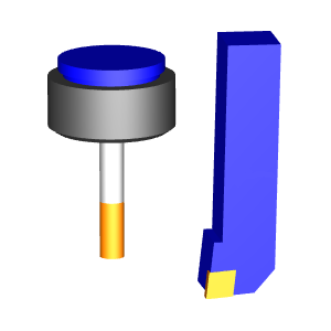

Shaded - will show an opaque tool.
Click
here to see an example.

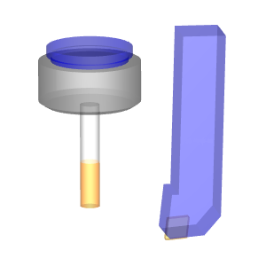

Transparent - will show a transparent
tool. Click

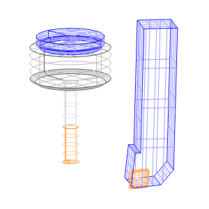

Wireframe - will show the tool
as a wireframe. Click here to see an example.
