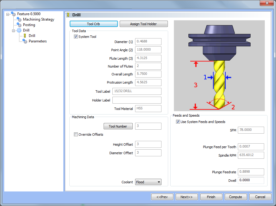

The Mill Hole Drill operation has three tool types to choose from: Drill, Endmill Rough, and Endmill Finish. It is good practice to have all the tools for the job loaded into the Tool Crib at the start of the job. By this point, those tools should already be in the Tool Crib, and the system will have pulled appropriate tools for each operation from the Tool Crib. From this tool page, you can either, choose a different tool from the Tool Crib, go into the Tool Crib to add tools from your Tool Library, or enter tool specific data manually into the Tool Data Section of the page.
System Tool
Select this check
box to allow the software to automatically select tools from the Tool
Crib that match the machining
operation. In the case of end mills, you may alter the diameter and corner
radius allowing the software to find the appropriate tool from the Tool
Crib. In the case the appropriate tool sizes are not found, the software
searches for a matching tool in the Tool Library. If a matching tool is
found, it is added to the Tool Crib. If a matching tool is not found,
a new tool is automatically created and added to the Tool Crib.
When this check
box is cleared, you can edit all tool information directly in the dialog
box. In this case, the defined tool is added to the Tool Crib.
NOTE: Tools and tool holders may be added or modified in the Tool Crib when it is accessed from the Milling Wizard Tool dialog box.
Tool Number - opens the Assigned Tools dialog box for you to change the tool numbering.
Override Offsets
Clear the Override Offsets check box to use the tool number to set the
Offset Register value.
Select the Override Offsets check box to allow for manual editing of the
Offset Register - sets the register on the machine that stores the height and diameter offset values for the tool.
Coolant - sets the coolant option for the operation. Select one of the following options: Off, Flood, Mist, Air, or Oil.
Use System Feeds and Speeds
Select this check
box to automatically calculate the feeds and speeds.
Clear this check
box to type feeds and speeds values in the dialog box.
Dwell - sets the amount of seconds to Dwell.
TIP: While editing the feeds and speeds, changing one value automatically calculates any other associated values. For example, if you modify the SFM value, the Spindle RPM, Cutting Feedrate, and Plunge Feedrate are automatically calculated.
