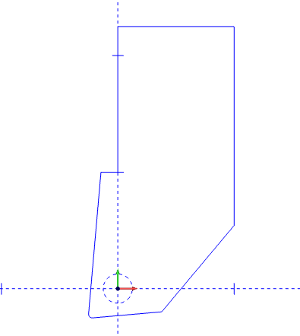

BobCAD-CAM allows you to assign geometry to define lathe tool holders that are used with the collision detection options in the Lathe Wizards.
1 In the graphics area, draw the 2D shape of the holder.
At the position of the attachment point of the tool insert, place a dashed circle.
It does not matter which dashed pattern is chosen, just that the circle itself is not solid.

The Tool Holder Definition dialog box hides to allow you to select geometry from the graphics area.
8 In the graphics area, click and drag a window around the entire drawing to select the holder geometry.
