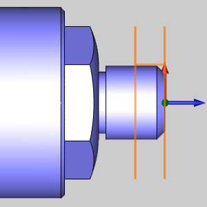

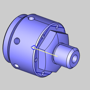

The following images show our example part. For this tutorial, we machine the part using stock that is already cut to length. For this reason, we create our features as though the model is split into two halves: front and back. This allows us to machine the front half of the part on the main spindle before transferring the part to the sub spindle and machining the back half. This is important to understand as this determines how we create some of our features.

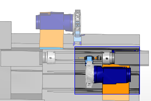

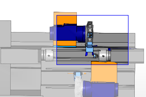

For this tutorial, all features are created using one of two machine setups: one for the front side and one for the back side of the part. The following images show the location and orientation of the machining origin (work offset) for each setup.
Machine Setup 1 |
Machine Setup 2 |
The Mill Turn job, stock, and machine setups are already defined in the example file provided for this tutorial. If you would like to learn more, view the Mill Turn Job Setup Example.

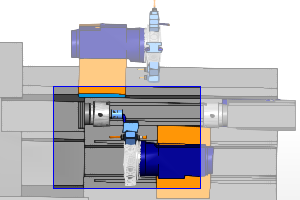

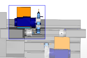

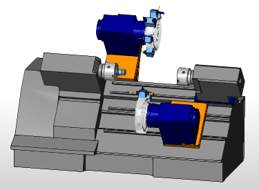

Before creating another feature, we simulate to confirm the toolpath is correct. The following steps provide an example of some settings that you may want to use during simulation. You can use some or all of these settings when simulating other features later in this tutorial.
1 To open simulation, right-click Mill Turn Job, and click Simulation.
2 The following provides some suggested simulation settings to get started.
Machine
Housing button to show the entire machine. For the BC 2T
2S machine, the machine base is assigned as part of the machine
housing. (
Toolpath
button to hide the toolpath from view.
Workpiece and
Stock
buttons are set to show the workpiece and stock.
Simulation
Run Speed slider
to adjust the playback speed of simulation as needed while simulating.
3 Click
the
Run button
to play the simulation.
4 To
close the simulation, click the
Exit Simulation button.
For more help with our extremely powerful simulation, view Getting Started with Simulation.

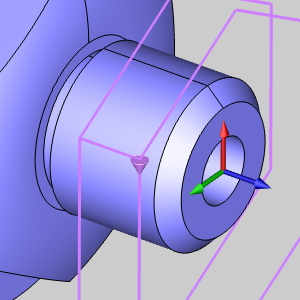

1 Right-click Machine Setup - 1, point to Turn Features, and click Lathe Hole.
2 Click Select Geometry.
Next we utilize a view option that helps us select a surface edge that is inside of the model.
3 Press the S key, to turn off the Shaded view. (Alternatively, in the View menu, click Shaded.)
4 Click to select the surface edge (at the bottom of the front hole) as shown next.
This selects the depth point for our feature and automatically sets the Total Depth from the selected geometry.
There is no need to confirm the selection, the software returns to the wizard as soon as you click the edge.
5 Click Next>> to go to the Feature Settings.
Notice that our Total Depth (1.7747) is automatically set from our geometry selection.

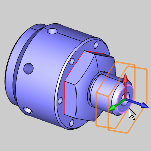

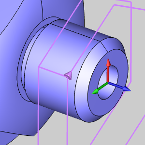

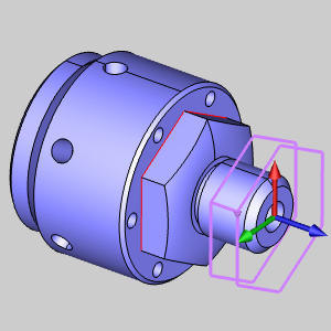

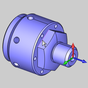

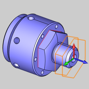

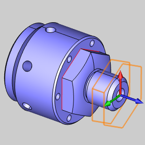

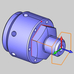

The next feature that we create cuts the hex on the front of the part using a single operation to remove the material that remains after our turning operation. Again, we alter the tool assignment so that we can use a finish tool with a rough operation type. (This is done for illustrative purposes, as otherwise you could use a profile finish operation to accomplish the same task.)
1 Right-click Machine Setup - 1, point to Mill Features, and click Mill 2 Axis.
2 Click
Select Geometry.
The Feature Geometry
Picking dialog appears with the focus on the Selected
Geometry list to allow you to select geometry for the feature.
3 Point to the surface at the bottom of the hex so that the surface edge highlights.
Right-click the edge (while it is highlighted) and click Constant Z to select a loop.

4 Click
on the top of the edge of the model to set that as the top of the feature.
Selecting Top Edge |
Top Edge Selected |
The Top
of Feature updates along with the preview, and focus is shifted
to the Pick Bottom list
of the Total Depth group.
5 Click
any edge of the surface under the hex.
The Total Depth updates along with
the preview.

It is suggested that you simulate the program after each feature you create. This makes it much easier to find mistakes and resolve them immediately.
1 On
the Other toolbar, click the
Simulation button.
Confirm that no changes are needed by running the simulation. Note again that you can use the Move List to go directly to the operation you are verifying.
You can also use the Report tab to check for any reported collisions during the simulation. Note that when you click an operation in the Move List (called manual navigation), no collision detection is performed for the operations that were skipped and a warning message displays in the Report tab.
2 Close the simulation.

3 Click to select the six cylindrical surfaces of the holes as shown next.
4 Click
(OK), to confirm the selection.
TIP: Selecting cylindrical surfaces allows the software to automatically detect and set the Feature parameters in the wizard for you.
5 In the Holes list, click to select the only hole item (0.25 Diameter).
Under Geometry Parameters, click to clear the Through Hole check box, because these holes do not go through the entire model.
Notice that our Diameter and Depth are automatically set to the correct values.

8 Simulate the program to view the part transfer.
Now that the part is transferred to the sub spindle, all of our machining features for the second half of the part are created under Machine Setup 2, which is set to Work Offset 2. Most of the remaining features use the UT_SS (upper turret, sub spindle) submachine, so we set the default submachine for creating features under Machine Setup 2.
1 Expand Machine Setup - 2 (if needed), right-click the current submachine name UT_MS, and click Edit.
2 Change the Submachine to UT_SS (upper turret, sub spindle), and click OK.
3 You can also collapse Machine Setup 1 to minimize the CAM Tree and reduce the need for scrolling.
