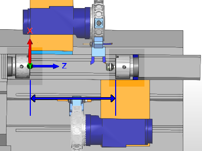

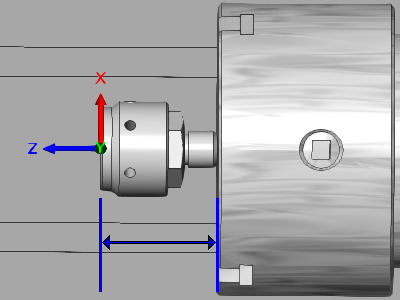

1 Under Other, click the Work Offset button.
2 In the Work Offset dialog box, notice that Work Offset #1 is selected by default. We use this offset number for Machine Setup 1.
3 Update the Z value to 5.00. This defines the distance from the virtual machine zero to the machining origin (in Z). This value is used later for simulation purposes.
4 Update the Subspindle Z value to 5.00.
This defines the distance between the virtual machine zero and the front face of the sub spindle. You use this value to determine the location to which sub spindle moves when transferring the part. (This value is only used for simulation purposes.)
NOTE: The Part Pickup Position parameter in the Part Transfer MDI command may need adjusted based on the value defined (Subspindle Z).

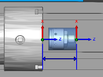

1 Click the Work Offset button.
2 Next to Work Offset # click the down arrow and select 2.
We use Work Offset #2 for the sub spindle and all features created under Machine Setup 2. These features machine the back half of the part.

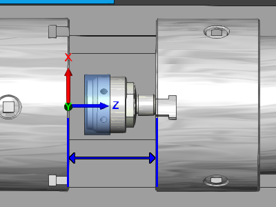

3 Update the Z value to 4.00. This defines the distance from the face of the sub spindle to the machining origin.
4 Notice that the Spindle Park Position value is already set to 36.00. The software automatically set this value based on the initial position of the sub spindle defined in the machine definition.
The Spindle Park Position defines the distance between the virtual machine zero and the front face of the sub spindle. This determines where the sub spindle sits while machining operations are performed on it.
We use the default value for this example to provide the maximum amount of clearance from other machine components (the main spindle) when working on the sub spindle. Depending on the size of your machine, you may want to change the park position to reduce the amount of sub spindle movement during the program if a large amount of clearance isn't needed.
