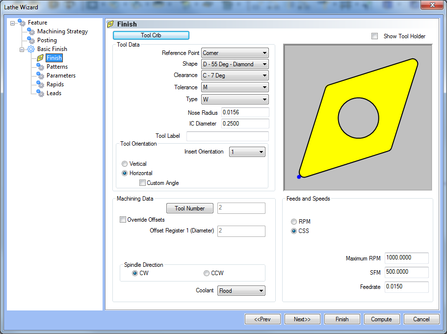

The Basic Finish operation has several tools to choose from. Whether you use a Rough, Finish, Groove, or Boring tool, it is good practice to have all the tools for the job loaded into the Tool Crib at the start of the job. By this point, those tools should already be in the Tool Crib, and the system will have pulled appropriate tools for each operation from the Tool Crib. From this tool page, you can either, choose a different tool from the Tool Crib, go into the Tool Crib to add tools from your Tool Library, or enter tool specific data manually into the Tool Data Section of the page.
Show Tool Holder - Selecting this check box will alter the graphic to show the holder as well as the insert.

Tool Data
    Corner
    Tip
    Center
  • Shape - sets the shape designation of the insert. ClosedClick here to see chart example.

  • Clearance - sets the clearance designation of the insert. ClosedClick here to see chart example.

  • Type - sets the type designation of the insert. This does not affect toolpath or output.
  • Tool Label - adds a name to the tool, in the tool list, that allows you to easily identify the tool.
Tool Orientation
  • Orientation Number - 1-4 sets the orientation of the tool as shown in the image. This selection influences the ability of the tool to move into locations that are restricted by adjacent geometry. The options available depend on the operation type.

Tool Data

  • Corner Radius - sets the size of the inserts corner radius.
  • Tool Width - sets the width of the insert.
  • Tool Height - sets the height of the insert.
  • Side Angle - sets the side angle of the insert. ClosedClick here to see an example.

Machining Data
  • Offset Register 1(Diameter) - sets the register on the machine that stores the diameter offset values for the tool.
  • Offset Register 2 (Height) - sets the register on the machine that stores the height offset values for the tool (Mill Turn jobs only).
  • Suffix Code - is an alphanumeric value used for the tool numbering for certain mill-turn machines, generally those with Mazak controllers (Mill Turn jobs only).
Spindle Direction
    • CW - outputs the command for clockwise rotation of the spindle.
    • CCW - outputs the command for counter-clockwise rotation of the spindle.
  • Tool Angle Control (Mill Turn only) - opens the Tool Angle Control dialog box for you to specify the rotation angles for both the milling head and lathe tool for the operation. This is used only for operations performed with a milling spindle/head and turning tool mounted to it.
Feeds and Speeds
Once the Finish Tool variables have been set, click Next >> to continue to the Patterns page.
