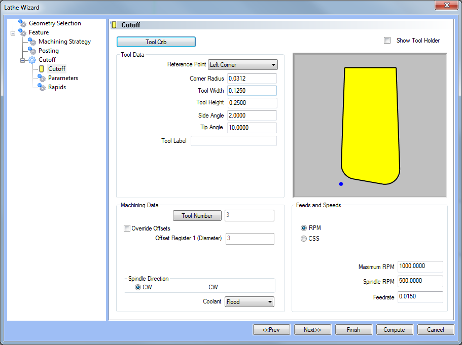

The Cutoff operation has only one tool type to choose from. It is good practice to have all the tools for the job loaded into the Tool Crib at the start of the job. By this point, those tools should already be in the Tool Crib, and the system will have pulled appropriate tools for each operation from the Tool Crib. From this tool page, you can either, choose a different tool from the Tool Crib, go into the Tool Crib to add tools from your Tool Library, or enter tool specific data manually into the Tool Data Section of the page.
Show Tool Holder - Selecting this
check box will alter the graphic to show the holder as well as the insert.
Deselected |
Selected |
Tool Data
- Reference Point - allows
you to choose an alignment of the reference point to the insert.
Left
Center
Right
- Corner Radius - sets the size of the inserts corner radius.
- Tool Width - sets the width of the insert.
- Tool Height - sets the height of the insert.
- Side Angle - sets
the side angle of the insert.
Click here to see an example.
- Tip Angle - sets
the tip angle of the insert.
Tool Label - adds a name to the tool, in the tool list, that allows you to easily identify the tool.
Machining Data
Tool Number - opens the Assigned Tools dialog box for you to change the tool numbering.
For Mill Turn jobs, view the Assigned Tools for Mill Turn.
Override Offsets
Clear the Override Offsets check box to use the tool number to set the
Offset Register value.
Select the Override Offsets check box to allow for manual editing of the
Offset Register 1(Diameter) - sets the register on the machine that stores the diameter offset values for the tool.
Offset Register 2 (Height) - sets the register on the machine that stores the height offset values for the tool (Mill Turn jobs only).
Suffix Code - is an alphanumeric value used for the tool numbering for certain mill-turn machines, generally those with Mazak controllers (Mill Turn jobs only).
Spindle Direction
CW - outputs the command for clockwise rotation of the spindle.
CCW - outputs the command for counter-clockwise rotation of the spindle.
Tool Angle Control (Mill Turn only) - opens the Tool Angle Control dialog box for you to specify the rotation angles for both the milling head and lathe tool for the operation. This is used only for operations performed with a milling spindle/head and turning tool mounted to it.
Coolant - sets the coolant option for the operation. Select one of the following options: Off, Flood, Mist, Air, or Oil.
Feeds and Speeds
RPM - sets the feeds and speeds to revolutions per minute.
CSS - sets the feeds and speeds to a constant surface speed.
Maximum RPM - sets the limits of the spindle speed in the posted NC program.
Spindle RPM/SFM - sets the spindle speed for the feature in revolutions per minute or the surface feet per minute based on the selected RPM/CSS option.
Feedrate - sets the feedrate for the feature.
Once the Rough Tool variables have been set, click Next >> to continue to the Parameters page.
