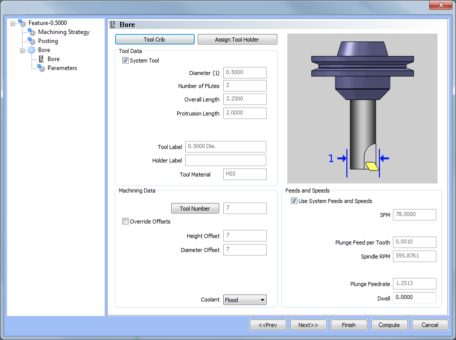

Bore Operation Tool Page
The Mill Hole Bore operation has only one tool type to choose from. It is good practice to have all the tools for the job loaded into the Tool Crib at the start of the job. By this point, those tools should already be in the Tool Crib, and the system will have pulled appropriate tools for each operation from the Tool Crib. From this tool page, you can either, choose a different tool from the Tool Crib, go into the Tool Crib to add tools from your Tool Library, or enter tool specific data manually into the Tool Data Section of the page.
Tool Data
  • System Tool
Select this check box to allow the software to automatically select tools from the Tool Crib that match the machining operation. In the case of end mills, you may alter the diameter and corner radius allowing the software to find the appropriate tool from the Tool Crib. In the case the appropriate tool sizes are not found, the software searches for a matching tool in the Tool Library. If a matching tool is found, it is added to the Tool Crib. If a matching tool is not found, a new tool is automatically created and added to the Tool Crib.
When this check box is cleared, you can edit all tool information directly in the dialog box. In this case, the defined tool is added to the Tool Crib.
Note: Tools and tool holders may be added or modified in the Tool Crib when it is accessed from the Milling Wizard Tool dialog box.
Machining Data
  • Override Offsets
  • Offset Register  - sets the register on the machine that stores the height and diameter offset values for the tool.
Feeds and Speeds
  • Use System Feeds and Speeds
Clear this check box to type feeds and speeds values in the dialog box.
  • SFM/SMM - is the surface feet/meters per minute feedrate.
  • Plunge Feed per Tooth - is the feedrate for plunge moves in units per tooth.
  • Plunge Feedrate - is the feedrate for plunge moves.
  • Dwell - sets the amount of seconds to Dwell.
Tip: While editing the feeds and speeds, changing one value automatically calculates any other associated values. For example, if you modify the SFM value, the Spindle RPM, Cutting Feedrate, and Plunge Feedrate are automatically calculated.
